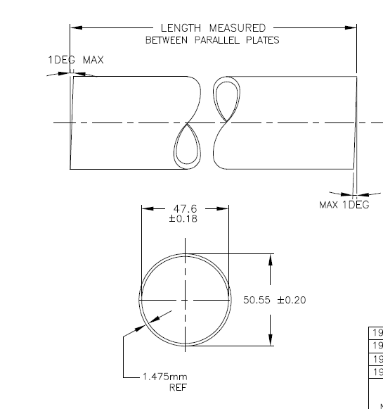

There is nothing to do with any carpet, This tube which is in this picture has to be coloured, The price for colouring this tube is 1m^2 = 9.33$, I need to find the price for 1m, I know what you mean about "m^2 is a two-dimensional area; m is one-dimensional length", The reason I keep asking is that one guy keeps on asking this answer and I don't know how to get this, this is how I answered but he is telling it is wrong and not giving me the answer, Please help me if you can.
circumference of a circle = $2\pi$ times the radius, or $\pi$ times the diameter
you seem to want the surface area of a hollow tube one meter in length with an approximate diameter of 50.55 units, which I'm assuming are millimeters ... note your cross-section is close to be circular, but is actually an ellipse.
$A = C \cdot L = \pi \cdot d \cdot L \approx \pi \cdot (0.055 \, m) \cdot (1 \, m) \approx 0.173 \, m^2$
based on that area ...
$\dfrac{\$ 9.33}{1 \, m^2} = \dfrac{\$ x}{0.173 \, m^2} \implies x \approx \$1.61$
