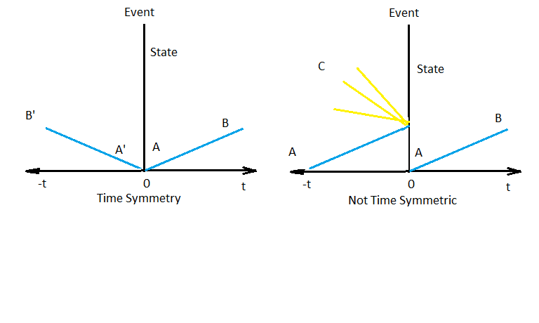

The time reversed films do illustrate that some physical quantities remain the same such as position, energy, acceleration and force, while others negate such as velocity and momentum.
But, If the time reversed film lasts long enough, one will notice some physical deviations from the laws of kinematics and dynamics, as well as electromagnetics.
For the solar system, the tidal bulge becomes retarded, having the effect that the moon's orbital radius is decreasing, along with a decrease in the earth's rotational period. The sun has become a heat sink, while the earth converts high entropy into low entropy radiation.
For illustratation,
T
The event A (A') occurring at time 0, evolves symmetrically in t time, or -t time to state B (B'), with A and A' having the same state conditons, and respectively B and B'.
In the second figure, state A has evolved to state B.
State B, in non-symmetric time reversal ( state B is shown transposed back to the origin of time 0 showing the non-symmetry ). State B could evolve back to state A, OR, most likely to some state C different from A.
