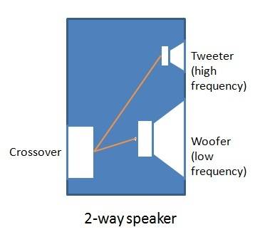

You can try this yourself with loudspeakers. A two-way speaker has got a bass element, "woofer", for bass and some midrange sounds, and a "tweeter" for higher frequency sounds. See Use of Multiple Drivers in Loudspeakers.
Picture of a two-way loudspeaker:
If you hold/place some cloth (e.g. blanket, towel or whatever) over the tweeter (but make sure you don't touch the membrane with the cloth, because this will change the sound), you will notice that high frequency sounds will be attenuated. If you do the same with the woofer (apply a cloth), you might notice some attenuation of midrange frequencies, but low frequency sounds (e.g. bass, bass drum) will still easily be heard more or less unchanged, regardless of the cloth. You should be able to do this with your hands instead of a cloth too. Try it, and hear what happens. See also Loudspeaker Sound Contours.
