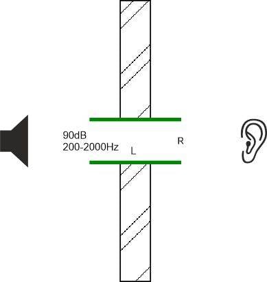

The problem I am trying to solve is as follows:
There is hole in plate. On one side of the hole there is a sound source, playing music. On the other side is a listener. For the simplicity we can assume:
  • The frequency range of the sound is the official hearing range of a human: 20Hz to 20kHz. Even for the sake of simplicity we can narrow it to the "telephone band" - 200Hz to 5000Hz.
  • The source of the sound for the simplicity is a single point.
  • There is just single hole.
  • Sound transfer is simple air at 20 deg celsius. Sound speed is 340m/s
  • The distance from the hole to the sound source is lets say 1 meter (if that matters)
  • The SPL (volume) of the sound is 90dB at the entrance of the hole. For simplicity.
  • Hole axis and sound source is in line. You can visually see the sound source from other side of the plate.
  • Plate is from some theoretically perfect material, non-resonant, fully absorbant, infinite dimensions, infinite mass, there is no reflections and refractions, sound transfer or other acoustic artefacts from the plate itself.
  • Hole surface on the contrary is from real life material, lets assume simple plastic, wood or iron. Surface is perfectly smooth. Inner walls do not absorb or interfere with the sound passing through.
  • Hole diameter R is something practical, like from 1mm to 10cm, in SI unit - from 0.001m to 0.1m.
  • Hole length L is also something practical, like from 1cm to 10cm, in SI unit - from 0.01m to 0.1m.
The diagram of the "problem":
The question is:
What diameter and length hole will block what frequencies of the sound? Which percentage?
Is there some rule of thumb or simple formula or graph to calculate approx. values?
The simple answer could be that the hole diameter should be in the ballpark of the 1/2 or 1/4 or 1/8 of the wavelength to make some kind of filter for the sound but as I understand, that does not work for such frequencies, at least in 20-2000Hz range. Audio speaker industry has many "vented" type speaker and subwoofer boxes of bass reflex, bandpass, MLTL and other vented types and the vents can pass those frequencies while being even ~0.05m in diameter. The wavelength of 30Hz sound wave is ~11.5 meters, so 0.05m diameter vent can pass a wave that is 230 times the length. I have no idea how that changes in the higher region of 2000Hz 20kHz, ultrasound or even higher frequencies, but there has to be another mechanics which is involved.
Thank you in advance.
If there is just a simple hole in the wall, then why do you draw the green tube?
Is L the length of the tube, or is L the thickness of the wall?
There will NOT be a single frequency that will pass, it will be a harmonic comb.
There will be a transfer function for the audio spectrum.

L - the length of the tube. It can be the same of larger than the thickness of the wall. Wall is acoustically a black hole, it absorbs everything. For the simplicity green tube is a hole, which is coated in real world material.
I do not think that there will be more than few % of difference because of diffraction from tube outside to the inside. I wanted the conditions to be simple. So the wall thickness and tube length is the same.
I do understand that there will be some spectrum that will pass, with most centered at one of multiple locations related to hole-tube L and R resonant frequencies or smth. If it is an exercise to find proper keyword then I am out of luck. Not much info on the web.

Real world scenario: the hole in wall is something you can drill - 5mm diameter R and 20mm length L. Ratio 1 to 4. Hole inside is 100% reflective. Music or pink noise plays on the other side of the wall. Which range from 200Hz to 5kHz will transfer best?
The numbers totally rule here - well done to inject some sense. A 200mm hole corresponds to one wavelength at 1.5kHz so @Baluncore ‘s “comb” of modes / overtones is very relevant. Transmission will be very low at some frequencies (nulls) and high at frequencies in between. Those sweet spots will transmit about 50dB less than an open window. (based on the hole area)That is a really annoying level in an otherwise quiet room.
Energy radiated from an isotropic point source, that then passes through an aperture, will be attenuated by the aperture. It will then be attenuated again by the inverse square law before it reaches the sensor beyond the aperture.
Where r is the radius of the hole, and d is the distance of the source beyond the hole.
Spherical surface area = 4πd² ; Aperture area = πr² ;
Power or Energy transmission coefficient = πr² / 4πd² = r² / 4d² ;
Pressure or amplitude transmission coefficient = r / 2d ;
For low frequencies, with λ > r, the energy passing through the hole will appear to re-radiate from a point source at the centre of the hole.
For higher frequencies, where the wavelength of the sound is λ ≤ r, the radiation pattern from the hole, will become progressively more complex, with nulls and side lobes.
Longer holes will have an impedance mismatch at each end, while they also form resonators.
