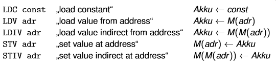

We have that MIMA (Neumann MInimal MAchine) has the following commands:
Code:
LCD const   :  Load constant
LDV adr      :  Load value from address
LDIV adr     :  Load value indirect from address
STV adr      :  Set value at address
STIV adr     :  Set value indirect at address

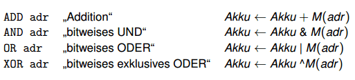

ADD adr      :   Addition
AND adr      :   bitwise AND
OR  adr       :   bitwise OR
XOR adr      :   bitwise exclusive OR

I want to write a MIMA program that takes the value $2^{23}-24=8.388.584$ to the memory $y$.
We have to take attention at the number of the bits, that we need for the representation of the number in two's complement.
How do exactly do we make the representation? (Wondering)
