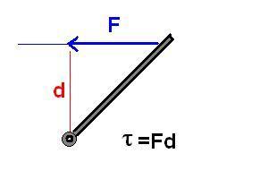

Can you give some example of external torque?
You need an external force F which is not parallel to the axis of rotation and its line does not go through the axis. You get the torque τ as force times the length of its arm d, τ=Fd. The "arm" is the distance of the line of force from the axis. When you push a door open, you exert a torque on it. The door interacts with the hinge, but your force causes an external torque.
ehild

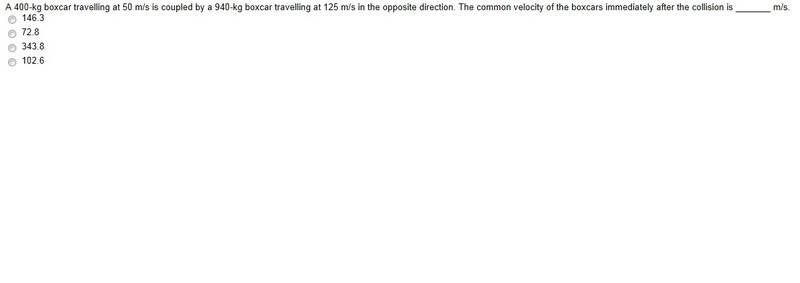

Thank you ehild. For the next question, how do you determine which momentum is -ve or +ve? Bigger momentum = +ve?
In this problem you decide which direction you take positive. You can choose the greater one.
