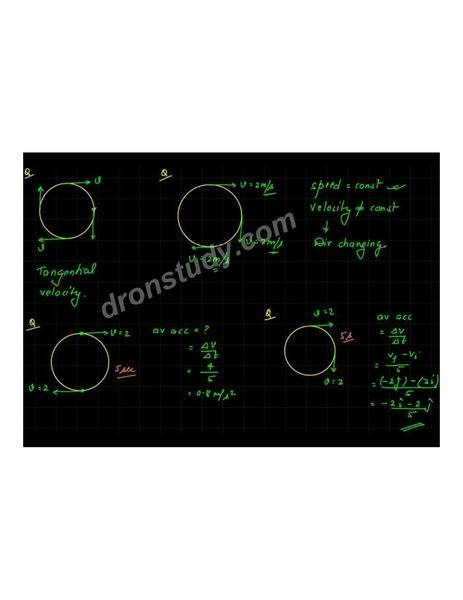

In circular motion what will be the change in velocity if initial velocity and final velocity is 2 m/s? From the left, in the 3rd diagram, if initial velocity and final velocity is 2 m/ s then what is the change in velocity? t = 5 s
the answer should be.
Acceleration = Vf - Vi / t = (-2i) - 2i / 5 = -4i / 5 = -0.8 m/s^2 but the answer is 0.8m/s^2.
  • Handwritten green-on-black whiteboard notes showing circular-motion diagrams with velocity arrows, average acceleration calculations and the text 'Tangential velocity' and 'speed = const, velocity ≠ const, velocity changing'.
I see two illegible drawings (pure black) and something in the middle with some semi-legible chicken scratchings.
I think you should re-state the problem and provide readable drawing, it is not clear to me. Hint: velocity is a vector, giving value like "2 m/s" is not sufficient.

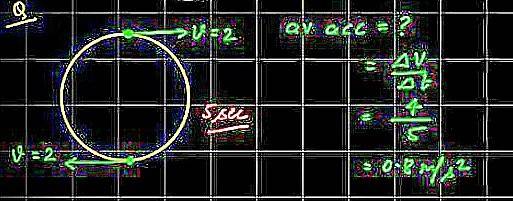

I have edited the image so that you can understand. Please see the image and let me know.

The question asks for a change in velocity but the answer is an acceleration? That's wrong.

(-2i) - 2i
How can both velocity vectors have same unit vector?
According to your drawing the first one, one is along j and another along i.
The pictures are still not clear. What are you using?

Yes, my question is that in the picture change in velocity is 4 or -4, As I know the change in velocity is Vf -Vi = (-2i) - 2i = -4i. please see the picture.

I would say that the change in velocity is neither 4 nor -4. It is -4i.

would you please let me know whether you could understand my edited image I provided so that in future I would edit my images to that degree. Is it readable?

It is not pretty, but it is magnified enough that I can read it.
