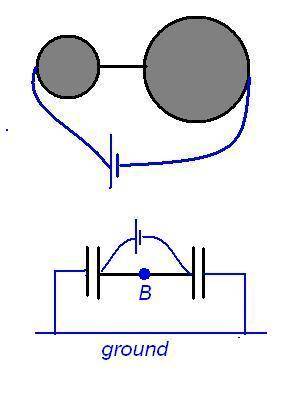

What if i connected the whole system with the battery? Will they be in series or parallel?
What do you mean? Connect one of the spheres with one lead, and the other sphere with the other lead of the battery?
Oh yes, that's what i mean. :)
I told you. Each spherical capacitor has the other of its plates at infinity (and all these plates may be thought of as connected to the ground). If you draw the relevant diagram, you will immediately conclude if they are connected in series or parallel.
See attachment. The connected spheres as capacitors are analogous to two "normal" grounded capacitor with the free plates connected. They are in parallel between B and the ground. What happens if you connect a battery in the way you said: one terminal to one plate of the first capacitor and the other terminal to the connected plate of the other capacitor?
See the connected spheres. They are of metal. So you make a metallic contact between the terminals of the battery. It is called "short", fatal for a battery. It gets very hot and starts to smoke and gets black and it is not a battery any more... RIP...
In case of a sphere as capacitor the other "plate" is at infinity. You need to connect the terminals of the battery to the wire connecting the spheres and to the other common point of the capacitors, which is at infinity.
