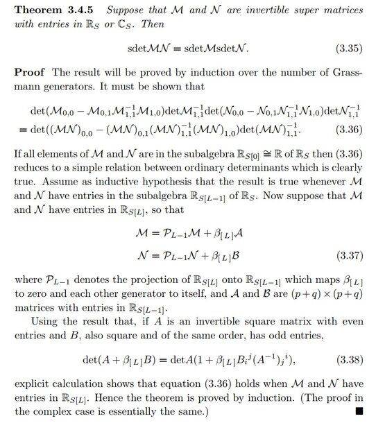

Reading Roger's book on supermanifolds one can find sketch of the proof for multiplicative property of super determinant. Which looks as follows
Typeset page from a book showing Theorem 3.4.5 on the multiplicativity of the super determinant, with its induction proof, equations (3.35) to (3.38), and a closing square symbol.
All the words sounds reasonable however when it comes to the direct computation it turns out to be technical mess and I am about to give up. I mean all the matrices that need to be inverted are invertible and can be represented as formal power series so everything is well-defined nonetheless resulting expressions are of insane technical complexity. Have someone tried this particular way of proving this property?
To add some detail of my struggle. I represent my super matrices according to suggested in the proof way
##\mathcal{M}=\left(\begin{matrix}M_{00}+\beta_L A_{00} & M_{01}+\beta_L A_{01} \\
M_{10}+\beta_L A_{10} & M_{11}+\beta_L A_{11}\end{matrix}\right)##
##\mathcal{N}=\left(\begin{matrix}N_{00}+\beta_L B_{00} & N_{01}+\beta_L B_{01} \\
N_{10}+\beta_L B_{10} & N_{11}+\beta_L B_{11}\end{matrix}\right)##
Since it is clear that result will be only linear in ##A## or ##B## I will provide only the part that comes with ##A_{01}## (nothing particular special about ##A_{01}##. I just want to see what comes here). After straight-forward computation one has
##sdet\mathcal{M}\, sdet \mathcal{N}=sdet M\, sdet N\, \left(1-\beta_L A_{01}M_{11}^{-1} M_{10} \left(M_{00}-M_{01} M_{11}^{-1} M_{10}\right)^{-1}+\ldots \right)##
I know that one should actually "take the trace" but I will omit the indices for simplicity. Appearing here matrix ##M_{00}-M_{01} M_{11}^{-1} M_{10}## is invertible since ##M_{01} M_{11}^{-1} M_{10}## has no body. Its inverse looks as follows
##\left(M_{00}-M_{01} M_{11}^{-1} M_{10}\right)^{-1}=\sum_{p=0}^\infty \left(M_{00}^{-1} M_{01} M_{11}^{-1} M_{10}\right)^p M_{00}^{-1}##
Series has only finite amount of terms so one doesn't need to worry about convergence properties.
On the other hand one can compute ##sdet \mathcal{M} \mathcal{N}## and again examine what comes with ##A_{01}##. Since resulting formula is very involved I introduce following shorthand notation
##\mathcal{X}=M_{00} N_{00}+M_{01}N_{10}-\left(M_{00}N_{01}+M_{01}N_{11}\right) \left(M_{10}N_{01}+M_{11}N_{11}\right)^{-1}\left(M_{10} N_{00}+M_{11}N_{10}\right)##
This one of the parts that comes computing ##sdet MN##.
##\mathcal{Y}=N_{10}-N_11 \left(M_{10}N_{01}+M_{11}N_{11}\right)^{-1}\left(M_{10}N_{00}+M_{11}N_{10}\right)##.
Once again all the matrices that need to inverted are invertible as a formal series.
Using these notation result for computation ##sdet \mathcal{M}\mathcal{N}## looks as follows
##sdet \mathcal{M}\mathcal{N}=sdet MN\, \left(1+\beta_L A_{01} \mathcal{Y} \mathcal{X}^{-1}+\ldots \right)##
I've tried to show equality order by order in ##N_{01}##. It is not that hard to show that in zeroth order (i.e. ##N_{01}=0##) equality holds. However when it comes to first order it turns out to be too involved.
