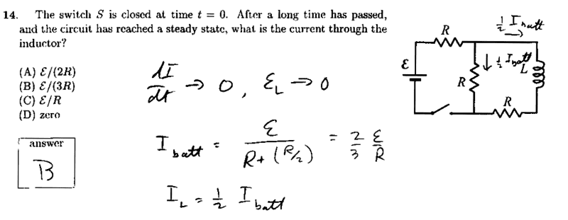

amninder15 Messages 19 Reaction score 0 Thread starter Apr 24, 2012 #1 Hi can someone please elaborate on the explanation our teacher gave us.
amninder15 Messages 19 Reaction score 0 Apr 24, 2012 #2 Here is the question Attachments Capture.PNG 14 KB · Views: 499
berkeman Admin Messages 69,838 Reaction score 25,774 Apr 24, 2012 #3 amninder15 said: Hi can someone please elaborate on the explanation our teacher gave us. amninder15 said: Here is the question Tell us what you know about the circuit. Then if you have a specific question, we may be able to help.
