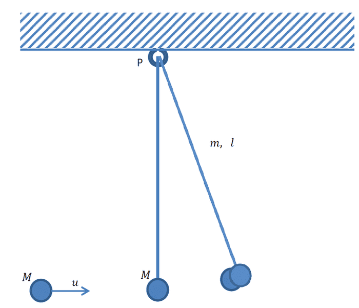

A homogenous, thin stick with the mass m and the length l is hanging from the ceiling and can rotate freely around the point P.
A small ball with the mass of M is attached to the end of the stick.
The small ball on the end of the stick gets hit by another small ball with the mass of M in a completely inelastic collision. Before the two balls hit, the ball not touching the stick is moving with the speed of u.
What is the sum of the angular momentum before and after the collision?
The moment of inertia for the stick itself is I = 1/3*m*l2.
I figured the total moment of inertia for the system after the balls collide would be (1/3*m+2M)*l2.
My initial attempt was to simply say that "Conservation of angular momentum must mean, that since the ball initially has the angular moment L = l*M*u around the point P. Therefore the resulting angular momentum must be equal that."
I however realized that I didn't understand what I was answering.

Yes angular momentum is conserved.
The angular momentum prior to the collision is quite easy to arrive at.
Expressing the overall angular momentum after the collision, in terms of the final speed of the balls is not quite as easy to get.

The angular momentum before the collision, with regards to the point P, must be L = l*M*u, since M is the mass of the moving ball and u is a movement vector perpendicular to the arm on where it will collide, l.
When the two balls collide on the end of the stick, the moment of inertia for the stick stick-system changes. Because of this, the way we calculate the angular momentum changes, but since it is conserved, it is still equal to the previous L.
There's supposed to be three parts in solving this task and I'm sitting with one that isn't even expressed in all the variables.
I suppose the first thing to ask is:
What is the sum of the angular momentum before the collision?
What is the sum of the angular moment after the collision?

If you were to be asked for the velocity, v, of the two balls immediately after the collision (in terms of m, M, u, and ℓ ), then that would give us a clue.
... or you might be asked for the angular velocity of the stick right after the collision. ...

This is one approach.
Then relate the angular velocity, ω, of this system to the velocity, v, of the two balls.
... or ...
The angular momentum after the collision is Iω + 2Mv . Would still have to relate v and ω .

Yes, I was talking about solving for v .
Is angular momentum (about point, P) conserved during the collision ?
I would very much assume it is, since nothing else has been said.
I don't know if I made it clear that it is a completely inellastic collision and the stick the ball is attached to has a mass, if this has anything to do with it.
With regards to finding the velocity, if L_before = l*M*u and L_after = I*omega, do I have to do any conversion work on the units in order to equate them? Can I simply say L_before = L_after?
Considering that the balls are at the end of the stick, the angular velocity is the same for all distances, I'm assuming that omega = v/l.
If I can equate the two, and this relation between angular velocity and velocity at a point is also true, I would assume that I could find the velocity, v, by solving for v in the equation:
l*M*u = I*v/l.

Mainly, LBefore = LAfter
Yes, ω = v/ℓ .
Use either I = (1/3*m+2M)*2 and LAfter = Iω2
or use
I = (1/3)*m*2 and LAfter = 2Mv + Iω2 .

The answer to the first question was as simple as you first suspected.
That's a shock to me, but I will accept it. I'll try to solve the next questions then.
