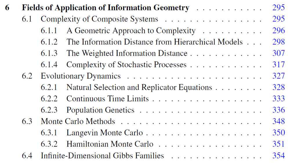

The book 'Information Geometry' of Ay et al. expands on some applications (see image attached).
There is also a fascinating quantum version of information geometry. As a teaser, consider this. The state space of a quantum system with finitely many states is [itex]\mathbb{C}P^n = \mathbb{S}^{2n-1}/\mathbb{S}^1[/itex]: the vectors of unit length (total probability =1) in the Hilbert space modulo [itex]\mathbb{S}^1[/itex] (states that differ only by a phase factor are physically indistinguishable). On [itex]\mathbb{C}P^n[/itex] there is a natural metric that comes from the round metric on [itex]\mathbb{S}^{2n-1}[/itex], the so-called Fubini-Study metric. Geometrically, [itex]\mathbb{C}P^n[/itex] is relatively simple to describe; it is the product of the standard [itex]n[/itex]-dimensional probability simplex [itex]\Delta_n[/itex] with a [itex]n[/itex]-torus with the edges identified in some complicated manner. But the fact remains that on an open dense subset, [itex]\mathbb{C}P^n[/itex] is just the product [itex]\mathrm{int}(\Delta_n)\times \mathbb{T}^n[/itex] and the Fubini-Study metric with respect to this factorization is the product of the Fisher metric (!) on [itex]\Delta_n[/itex] times a metric on [itex]\mathbb{T}^n[/itex] that varies with where we are on [itex]\Delta_n[/itex].
Source: 'Geometry of quantum states: An Introduction to Quantum Entanglement'. Bengtsson et al. (2017). Also Gromov's meditations on Entropy: https://www.ihes.fr/~gromov/expository/579/
