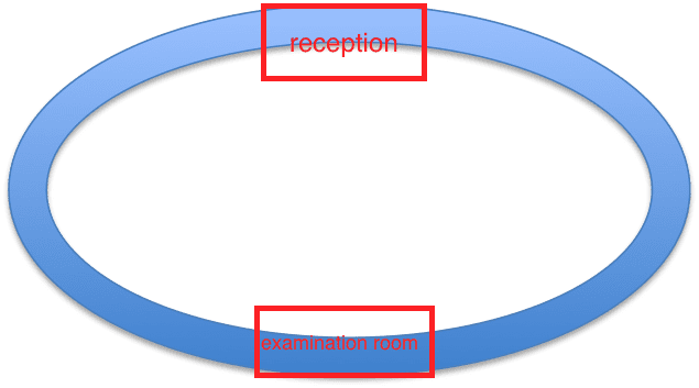

A 60kg patient arrives at the Reception area on a wheelchair that is 8kg. The healthcare professional has been asked to push the wheelchair to the Examination Room. The corridor from the Reception area to the Examination Room follows a circular path.
The healthcare professional pushes the wheelchair from its resting phase and maintains a steady speed of 2m/s as the wheelchair travels to its destination, which is 25m from the Reception area. It takes the Healthcare professional 80. sec to push the wheelchair patient from the Reception area to the Examination Room 2. Homework Equations

I think the question is poorly stated, is that exactly as the book says?
I understand it that the wheelchair traverses a semicircle with diameter of 25m which is definitely not a distance of 160m as you've calculated.
That is, your assumption of instantaneous acceleration is incorrect.

Yeah i thought my answer was completely wrong! The question is copied exactly word for word. I just assumed that i would state the answer is 2m/s as it is a 'Steady' speed? but then that also doesn't seem right?
Why semicircle? (I think chapp drew the diagram, so don't read too much into it.)
I'm not so sure. Reading back now, only the diagram implies a semicircle.
Either way, a terribly worded question that doesn't appear to have a solution.

Its not out of a book, the questions were given to us from the teachers and that's the diagram that was given to us too.
In that case maybe my initial interpretation was right.
That is, the distance traveled is 25m*π/2
in a time of 80s gives an average speed of ~0.5 m/s
If constant acceleration is assumed a max speed of 1 m/s is reached at the destination.
Or if we assume a constant speed of 2 m/s we end up with a travel time of ~20 seconds
I suspect the healthcare professional has traveled via the cafe and had a snack in the missing minute (or alternatively warped his perception of time after a trip to the drug cabinet).
Are you sure it says "maintains" or is it "obtains"?
If it was "obtains" then I think you have a period of acceleration followed by a period of constant speed motion.
s = distance, v = final velocity (2ms), t = time
For the first phase..
s1 = 0.5 vt1 .... 1
For second phase
s2 = vt2......2
Also
s1 + s2 = 25m...3
t1 + t2 = 80s.....4
Four variables and 4 equations so can be solved.
You can then calculate if it has reached 2m/s by the time it gets to within 5m of the end. Perhaps it hasn't, I haven't checked.

Another possibility is that he accelerates until he obtains 2m/s then decelerates. but then you have to take issue with the word "steady" in the problem statement.
