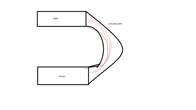

A wheelchair is pushed from the start to the finish from its resting phase and maintains a steady speed of 2m/s as the wheelchair travels to its destination, which is 25 m from the start. It takes 80.seconds to push the wheelchair from the start to the finish. What is the wheelchair's instantaneous speed when the wheelchair is 5m away from the end? (Forgive the crude drawing)
V= d/t
Cir = 2 pi r
There's one of two possible solutions. the speed is 2m/s because the question states that the wheelchair maintains a speed of 2m/s as its speed. But that doesn't sound quite right to me
Considering that the path is circular from the start to the finish. And the start and finish areas are 25 meters away from each other then the circular path is
Cir = 2 pi r
= 25 pi
= 79 meters long
Therefore we need to know the speed at 74 meters.
I could then say that V=d/t
so V = 79meter/80. seconds
= 0.99 m/second
But that doesn't seem to make sense. Am I over thinking this here?

While that is all true, the question still makes no sense. At 2m/s for 80 seconds it should cover 160m, yet the start and finish are only 25m apart and the path is supposed to be along a circular arc. Even two complete circles does not quite get to 160m.
Gojoel, are you sure you have stated the question exactly as given to you?
Path is along the circular path. And I've pretty much stated the question as is. That's why I didn't get it. I think the answer is 2m/s and someone stuffed up. I'll check it out.

Basically the question is define instantaneous speed and deduce what its value will be when the wheelchair is 5m away from the end. Justify your answer. Is there a difference between instantaneous speed and steady speed?
Could be the circumference is somewhat greater than 160m. The 25m distance could be the straight line separation (a chord of the circle)? It fits the statement but doesn't really help solve the problem.
So I got this from the lecturer.
I can see that many of you are still struggling with Section A Question 2 so I am rephrasing the question and hopefully it will start making more sense.
In this question, you are to assume that the wheelchair is moving at a steady speed of2m/s when it is 5m away from the Examination Room(end of the path). You need to now deduce if the Instantaneous speed will be equal to, less than or more than 2m/s and explain why. You do not need to use any formulas.
Hope the rest of the assessment is progressing well.
The path is 25m in length as well. So that would mean that the instantaneous speed is 2 m/s, when 5meters from the examination room. Because it is 2m/s at the instant it is 5 meters away from the examination room?
So the 25 m is distance along the path, not a straight line.
