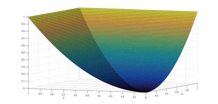

I consider the region of integration thusly
There is symmetry about the line y = x. Below this line, the max value is of y squared, since for y < x, y2 > x2. And so above the line y = x, the max value is x squared.
This is true because 0 <= x <= 1 and 0 <= y <= 1.
Using Matlab to sketch the 3-D graph gets
3-D surface plot over the unit square with x and y axes from 0 to 1 and z from 0 to 1, rising from a valley along the diagonal to height 1 at the far corners; colour map shifts from dark blue to yellow.
This looks right, and we can see the symmetry.

The code I used to generate that graph is
[x,y] = meshgrid(0:0.01:1,0:0.01:1); % 0.01 increments
z = max(x^2,y^2);
surf(x,y,z)
so, I figure for a good approximation of the volume under that surface should be
sum(sum(z.*0.0001)); % element-wise multiplication of z by 0.01 x 0.01
But this gives 0.513433500000000 which is not e - 1.
Is my analytic solution incorrect or my numeric approximation method? Or both?

I'm not familiar with Matlab, but didn't you forgot the exponential in the definition of z ?

There is no exponential. The purpose of the graph was just to see where [itex]x^2[/itex] was larger and where [itex]y^2[/itex] was larger.
Though that was not really necessary. Since both integrals are from 0 to 1, both x and y are always positive and so [itex]x^2= y^2[/itex] means x= y. [itex]max(x^2, y^2)= x[/itex] if and only if x> y and [itex]max(x^2, y^2)= y[/itex] if and only if x< y. So the integral, [itex]\int_0^1\int_0^1 e^{ax(x^2, y^2)} dxdy[/itex] can be written [itex]\int_0^1 \int_0^x e^{x^2} dydx+ \int_0^1 \int_x^1 e^{y^2} dydx[/itex].
However, x= y only on the boundary not everywhere in the region of integration so [itex]e^{x^2}[/itex] is NOT always equal to [itex]e^{y^2}[/itex]. Perhaps you simply meant to appeal to symmetry to say that the two integrals are the same?

I absolutely did..Ok...this is the second time this week that my reading comprehension has brought me to PF...maybe I can build some sort of mechanical hand to slap me in the face if I don't proof read...thanks

Update, making that correction to the code makes the numeric and analytic answers line up. Thanks for your help :)
