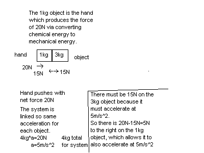

I think I have got this problem covered. It all works out. Look at the diagram with explanation.

I chose the pair I did in the OP because I didn't fully understand how they worked. However, I drew a diagram which hopefully showed that it all works. What do you think about the information in my diagram? Do you think my diagram is incorrect? Pairs like earth-hand, I always understood so I didn't consider it.
Why can't I choose any pair I want? Could you answer this question. Your help is appreciated but I may not have fully understood you.
I have done a very poor job of explaining this and am sorry. As a person who tutors for a living, I am ashamed! But I am certainly no expert
I don't follow your diagram after looking at it carefully... the box on the bottom right... 20N applied, this is always applied. When you apply the 20 to the 1kg box, you get 20m/s^2 acceleration. At this time the box is pushing whatever is pushing it back with 20N force. This is likely to be the whole earth, as the pushing mechanism is attached to the earth. Then the box strikes the 3kg box, and they become a 4kg box. They are at the same box essentially, as they are not accelerating with respect to each other (only for a moment they did). Now they still have 20N of force applied, so they are accelerating at 5m/s^2. If the frictional force is low and they accelerate beyond your hand, so be it. Then they lose there source of force, and continue on losing whatever velocity to the friction.
Maybe my diagram isn't clear but I stated that the 1kg object is the hand itself, not literally a lifeless box. So the 1kg 'box'=hand is actually providing the 20N force. There is no force exerted onto the hand. So the 20N is the force pushing the hand as well as the 3kg real box.
If the 1kg box=hand was not pushing any other boxes than the acceleration would be 20m/s^2 but it is pushing another box so the acceleration itself will not be 20m/s^2. Both the hand and box must accelerate at the same acceleration which was the original condition. And if we do an experiment and use my hand to push a box, my hand can accelerate with the box.
An object, your hand included, cannot "push itself"--it requires an external force to accelerate. If it's accelerating along with the box, then a net force is acting on it:
Forces on box: The hand pushes the box with 15 N of force; the 3 kg box accelerates at 5 m/s^2.
Forces on hand: The box pushes the hand with 15 N of force to the left; Whatever is attached to the hand (your arm/body) pushes the hand with 20 N of force to the right. The net force on the hand is 5 N to the right--it accelerates at 5 m/s^2.
I specified on my digram that inside the hand, chemical energy is converted into mechanical energy so the hand is pushing itself that way. You don't think it's good? You think it is better to model the situation as an external force pushing the hand? When the external force came from within the hand itself.

External force cannot come from within an object. If you are concerned with the acceleration of an object, you must consider all forces on that object. A hand is no different.
Think of a car. You can step on the gas all you want (converting chemical energy to mechanical energy), but you won't go anywhere without an external force--the friction of the road pushing on the tires. An external force is required to accelerate the car, just like an external force is required to accelerate your hand.

I see that an external force is recquired to move a car (which is from the road in the form of friction). But what is the external force that is recquired to move a hand? Force from the arms? What will move the arms, force from the shoulders? What will move the shoulders? Force from the body? What will move the body? ...
In this situation it seems like an infinite descent where does it end? However, with the car example, things are simple, force of friction via the road is exerted to the car to make it move forwards. This friction force comes as the result of rubbing the tyres with the road. The action-reaction pair is straight forward in this case.

Yet, if you want your hand to accelerate there must be external forces on it. The net force must be such to give it the desired acceleration. Yes, the wrist pushes on the hand!
It might seem an infinite regress, but it's not. At some point, you are pushing against the earth--that's as far as we need to go. If the acceleration you wish to create is small enough, and you only need it for a brief while, your body may itself have enough mass to push-off against.
"Action-reaction" pairs are always straight forward. Your hand pushes the block, the block pushes your hand; your wrist/arm/shoulder pushes your hand, your hand pushes your wrist/arm/shoulder.
To analyze the motion of the block, all you need are the forces on the block. But if you want to analyze the motion of the hand, you'd better include all the forces on the hand.

I could still accelerate my bodily parts in free fall in space, without touching anything else. In that case would you say, a part of my body i.e. arms is pushed forwards and the body experiences a force backwards as a reaction.
Absolutely! For example, you can accelerate--briefly--your arm with respect to your body. That means you can exert forces between one body part and another. But you cannot accelerate your center of mass--that requires an external force from something outside your body.
Yes! Your body pushes your arms forward; your arms push your body backward.
But in all cases, whatever is being accelerated requires an external force. (Your arm can't accelerate itself; something external to your arm--your torso, perhaps--must push on it.)
