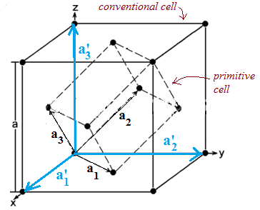

The interplanar spacing between planes labeled by miller indices (hkl) is given by:
d=2[itex]\pi[/itex]/lGl
where G is the reciprocal lattice vector:
G=hb1+kb2+kb3
Somehow I can't get this formula to work. I wonna calculate the distance between (200) planes. This should be a/2, where a is the lattice constant. But (look it up) b1=2[itex]\pi[/itex]/a (-x + y +z), where x, y and z are unit vectors. And so G= hb1 = 2[itex]\pi[/itex]/a (-x + y +z) and thus lGl = h2[itex]\pi[/itex]/a * √3
d= a/(2√3)
But this can't be right. I have no idea why I get that factor of √3, because I checked everything. Where did I make a silly mistake?
From your expression for b1, it appears that you are working with a face-centered-cubic lattice (in real space) and that you have chosen reciprocal lattice vectors that are reciprocal to a set of primitive lattice vectors corresponding to a primitive cell. However, for fcc and bcc lattices the miller indices are often chosen to correspond to a conventional cell.
For information on primitive and conventional cells: http://www-personal.umich.edu/~sunkai/teaching/Winter_2013/third_lecture.pdf
The unprimed vectors (a1, a2, a3) in the diagram that I attached show lattice vectors in real space that correspond to a primitive cell of the lattice. The primed vectors correspond to a conventional cell.
So, the Miller indices (2, 0, 0) probably correspond to the conventional cell. If so and you want to use d=2[itex]\pi[/itex]/lGl, you will need to find the reciprocal vector b'1 that is reciprocal to the conventional cell lattice vectors (a'1, a'2, a'3).
  • Diagram of a cubic cell with its primitive lattice vectors a1, a2, a3 drawn from a corner, and the conventional cubic cell vectors a'1, a'2, a'3 along the x, y and z axes; labels mark the conventional cell and primitive cell and the edge length a.
