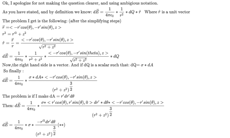

I know this can be solved by first considering a ring, deriving a formula for it, and then summing the infinite number of rings that make up a disk (via integration), and thus, the desired result is yielded. However, I am more interested in how to approach this using surface integration?I started with the parametrization G(u,v) = <ucos(v),u*sin(v),0> and found the normal unit vector to be <0,0,1>
where: 0<u<R and 0<v<2*pi
But, I am not sure how to continue from there, I attached a pdf showing my subsequent steps, which I am not sure if it is valid or not.
Please help, and thank you in advance.

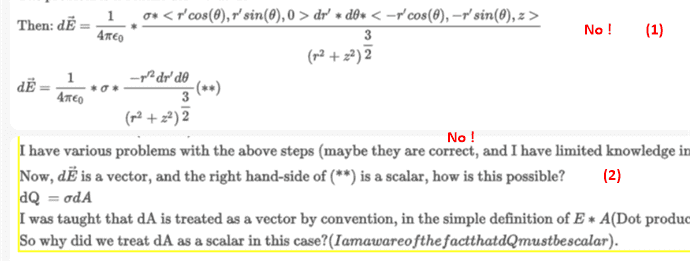

Your expression ##dr\,d\theta## for ##dA## is wrong. It needs to have units of area. You forgot to multiply by the Jacobian, which will give you a factor of ##r##.

You have ##\vec r = \vec p -\vec r' ## with ##\vec p =<0,0,z>## and ##\vec r'= <r'\cos\theta,r'\sin\theta,0>## and ##\hat r = {\vec r \over |\vec r|} ##
And then I can follow $$d\vec E = {1\over 4\pi\varepsilon_0} \; {1\over r^2}\;{\vec p - \vec r' \over |\vec r| } \; dQ$$
where ## dQ = \sigma dA = \sigma r' dr'\, d\theta ## (*)
Note that ##dQ## is a scalar !
( (*) I have the impression you overlooked the factor ##r'## ? Nice to see vela agrees...)​

Except that it looks as if you think ##dA## is a vector and then in the subsequent
you come up with dot product ##\vec r \cdot \vec n##
I don't think it's valid, but here it works because you pick out the ##z## component, which is the only one that doesn't cancel from symmetry.

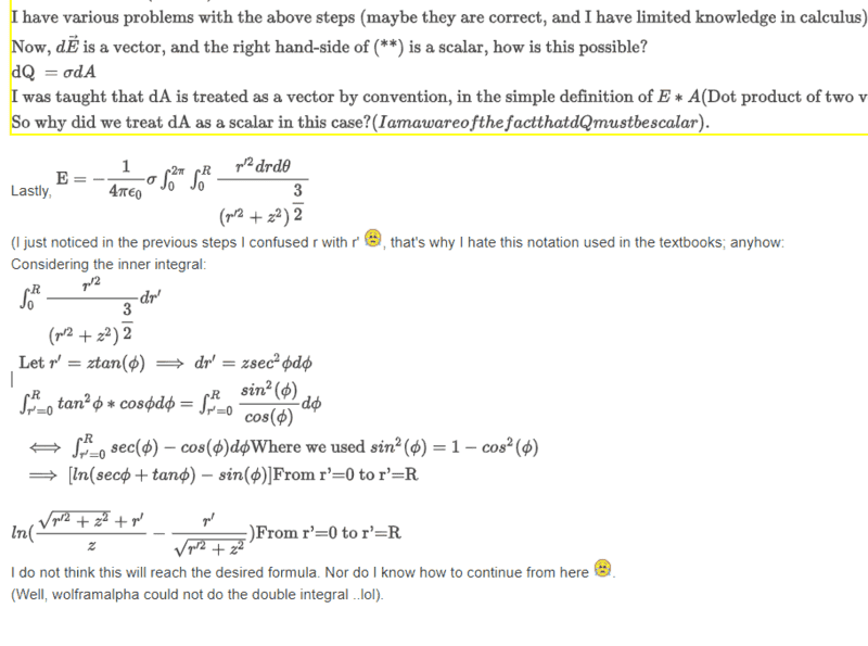

I think my main initial problem was treating the problem as a vector surface integration question, and in this, we always convert F*dA(vector) to scalar surface integral by parametrization and finding the normal vector (which is kinda the "jacobian"). But, as both of you have stated, I just realized that it is just a double integration problem and no need for vector fields I guess.

Yep. As stated, ##dQ = \sigma \, dA = \sigma \,r'\,dr'\, d\theta## , ALL scalars. So you can't replace ##r'\ (=|r'|) ## by ## <r'\cos\theta,r'\sin\theta,0>##
(1) not correct to replace ##dA## by a vector
(2) you take a dot product where you should multiply with ##|r'|## (and in the denominator you write ##r^2## instead of ##r'^{\, 2} \ ##)
