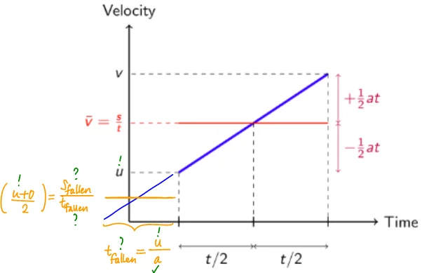

For interest - comments welcome.

I am trying to understand why your approach is preferable to the traditional approach. Traditionally, I would say:
Part (a): Find the velocity ##u## at the top of the window.
The known quantities are the transit time ##\Delta t=0.1~##s, the transit distance ##\Delta h=1.5~##m and the height of the building ##H=100~##m. I choose the origin at the top of the window and time ##t=0## when the stone is at the origin. Taking "down" as positive, ##x(0)=0## and ##\dot x(0) =u##. Also at ##t=\Delta t=0.1~##s, ##x(t)=1.5~##m and ##\dot x(t)=u##. Equation (2) becomes, $$\begin{align} & x(t)=x(0)+\dot x(0)t+\frac{1}{2}(\text{const.})t^2 \nonumber \\
& \Delta h=u\Delta t+\frac{1}{2}g(\Delta t)^2 \nonumber \\
& \implies u=\frac{2\Delta h-g(\Delta t)^2}{2\Delta t}
=\frac{2\times1.5~\text{m}-9.8~(\text{m/s}^2)\times (0.1~\text{s})^2}{2\times 0.1~\text{s}} = 14.51~\text{m/s}.\nonumber
\end{align}$$Part (b): Find the height of the window.
This part can be answered by using the auxiliary equation as shown in post #1 and will not be repeated here.
So finding ##u## the old fashioned way is just as quick as using the average velocity perspective. The ##\pm## Relationship is obtained directly from Equations (1) and (2) by dividing through by time ##t## which more appropriately should be written as ##\Delta t## to distinguish it from "clock" time ##t##. My point here is if you use ## t ## for an interval, what symbol will you use for clock time to avoid confusion in students' minds? Clock time becomes important in categories such as "Catch up" problems.
Also, if you insist on using intervals, why is the "drop" relationship limited to ##u=0##? Why not use the more general expression and say, $$
\begin{align} & \bar v = \frac{(v+u)}{2}~;~t=\frac{(v-u)}{a}~; ~s=\bar v t \nonumber \\
&\therefore~~s=\frac{(v+u)}{2}\frac{(v-u)}{a}\implies 2as=v^2-u^2 \nonumber
\end{align}$$and then narrow Equation (3) down to ##u=0## if you must?

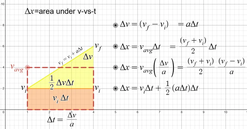

Intuitive: Treats motion as a deviation from the mean.
Did you mean non-inertial motion?
So, with your ##a=9.8\rm\ m/s^2##,
upward-increments along the Velocity-axis are associated with "downward acceleration".
Interesting presentation.
I never thought of , for constant-acceleration,
$$v_{i} ,\ v_{f} \quad = v_{avg} \mp (a\Delta t)/2 \quad = \frac{\Delta x}{\Delta t} \mp (a\Delta t)/2 $$
In my opinion,
  • "velocity" MUST be defined FIRST as the "slope-of-x-vs-t"
  • "average-velocity" MUST be defined LATER as the "time-weighted-average of velocities"
    (and that ##v_{avg}=(v_f+v_i)/2## is only for constant-acceleration, as @kuruman suggests)
    [My preference is that "velocity" is the first definition students see, otherwise, in my experience, it seems when I ask for "velocity" at certain time [in an accelerated motion, like freefall], I often get (sadly) average-velocity.]
  • "acceleration" MUST be defined as the "slope-of-v-vs-t"
  • "displacement" can be interpreted as the "area-under-v-vs-t"
  • "average-velocity" should also be interpreted as
    "the [steady] constant-velocity needed to complete the same displacement in the same time-interval",
    which means (as you suggest):
    on a v-vs-t-graph, the height of the rectangle with base ##\Delta t## that has the same area as the area under the v-vs-t graph (here, the area of the trapezoid)
To add more "geometry" to the "Geometry of Motion",
it might be good to point out more geometrical information encoded in the trapezoid,
which could help connect to the standard textbook kinematics equations for constant-acceleration.
See below for details.

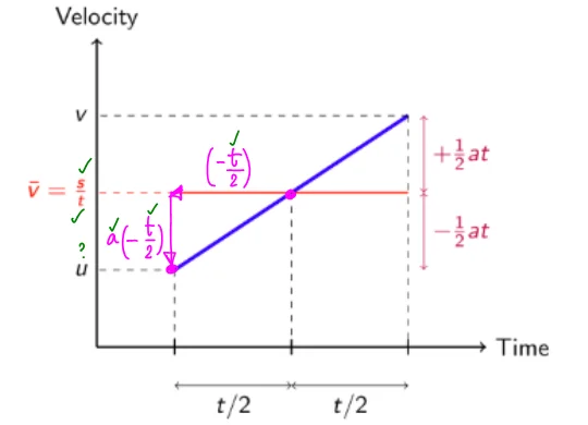

For your problem,
using your diagrams,
here is your step 1 (with my emphasis on ##(-t/2)##)
here is your step 2 (not to scale)
See my desmos.com/calculator/00069a84c7

Thanks very much for your detailed comment - no apologies needed. Yes - for this particular lesson on interval kinematics we should indeed be using ##\Delta t## and probably ##\Delta v## and ##\Delta s## as well. I think the use of this equation is indeed conceptual since one can visualize exactly what is happening rather than just use a formula. A moot point since the formula itself (as pointed out by @robphy) can be derived directly from area under the velocity / time graph so can also be 'visualized' although I think not many students will actually appreciate that. Am in the process of developing lesson(s) which will emphasize the geometric / graphical origins of these equations rather than just presenting and using them. Have a few different derivations of the key equation v^2=u^2+2as. (area under v-t curve, conservation of mechanical energy and average velocity x time).
A confession - if it wasn't obvious - is that such lessons (including the above) are "AI-assisted". I come up with the basic lesson idea (eg u,v formula and drop equation above) and AI implements in Latex code. If asked, it can also include graphics (tikz code) and slide presentation (beamer) both via packages available within Latex. So the 'drop equation' in this case is limited to cases where initial velocity = 0 by design. The 'raw' AI lesson can then be modified based on feedback received as I will do here. Minor changes can be directly implemented by Latex code 'tweaks' but mostly AI simply regenerates from scratch.

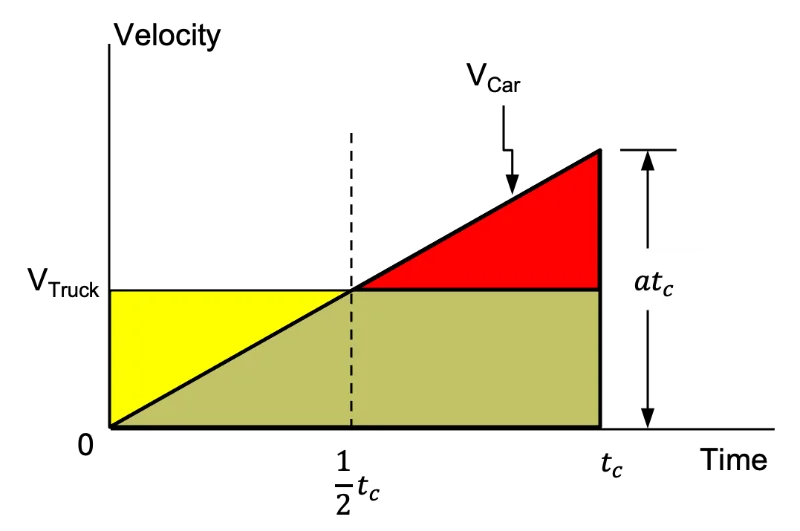

Therein lies the rub. If you intend the students to use the interval kinematic analysis as a tool for answering conceptual type questions, i.e. no numerical calculations, then it's fine. If you want your students to calculate numbers, they will have to memorize one or more equations to use as a starting point. What equations can these be? Nothing different from what can be obtained by using the two solutions of the diff-eq plus the auxiliary equation in post #2. So memorizing and using a formula is not necessarily something to be avoided.
That said, I would encourage you to extend the use of interval kinematics to the use of velocity vs. time plots as a geometric alternative to algebraic manipulation for solving problem. Here are two examples drawn from PF threads.
Problem 1
A car is at a stop light, when the light turns green a truck blows through the intersection at ##V_{\text{Truck}}##, and remains constant. The car begins to accelerate (assume at the exact same time as the truck goes through intersection) with acceleration ##a##.
(a) How far away from its initial point is the car when it passes the truck?
(b) How fast is the car going?
Solution
Draw a Velocity vs. Time diagram for the two vehicles as shown on the right. The car velocity is a sloping straight line while the truck is a straight line parallel to the time axis. The vehicles have traveled the same distance at time ##t_c## when the area of the rectangle is the same as the area of the triangle.
Part (a) $$\begin{align} & V_{\text{Truck}}t_c=\frac{1}{2}at_c^2 \implies t_c=\frac{2V_{\text{Truck}}}{a} \nonumber \\
& \Delta x= V_{\text{Truck}}t_c=\frac{2V_{\text{Truck}}^2}{a}. \nonumber
\end{align}$$
Part (b)
Note that the areas under the triangle and rectangle consist of a common piece plus a yellow right triangle completing the rectangle's area and a red right triangle completing the triangle's area. These triangles are obviously similar and also congruent because their sides parallel to the time axis are equal. Therefore the sides parallel to the velocity axis are also equal. It follows that at time ##t_c## the instantaneous velocity of the car is twice the constant velocity of the truck.

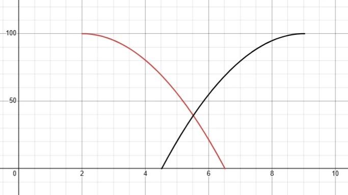

Problem 2 (More complex)
Two balls are dropped from a top of a cliff at a time interval of ##t_0##. The first ball hits the ground and rebounds elastically, essentially reversing its direction instantly without losing speed. It collides with the second ball at height ##h## above the ground. What is the height ##H## of the cliff?
As shown here, the relevant equation obtained from a Speed vs. Time plot is $$\frac{\sqrt{2gH}-\sqrt{2g(H-h)}}{\sqrt{2gH}}=\frac{\frac{1}{2}t_0}{\sqrt{\frac{2H}{g}}}.$$ It needs to be solved for the height of the cliff ##H## in terms of the other quantities.

Still working on problem 2 - here is a graph so long but hasn't solved things.

Velocity vs time graphs for ball 1 and ball 2

To more specifically address the questions above we may note:
1) Mechanical energy is conserved for both balls and always totals mgH where H is the drop height.
2) Following from 1) the velocity of both balls originates from "converted" potential energy. Hence velocity at height h above the ground is ##\sqrt{2g(H-h)}##
3) The first ball strikes the ground at time ##T_0## and the second (assuming an uninterrupted trajectory) at time ##T_0+t_0## where t_0 is the delay interval between dropping ball one and ball two. In between the upward bouncing ball meets the other on its downward trajectory at height h above ground. At this point the respective velocities are equal and opposite with magnitude ##\sqrt{2g(H-h)}##.
4) Ball one started its bounce with velocity ##+\sqrt{2gH}## and had velocity ##+\sqrt{2g(H-h)}## when it collided with ball two. Upon collision, ball two had the same velocity in the opposite direction and (had it continued its trajectory uninterrupted) would strike the ground with velocity ##-\sqrt{2gH}##. The change in velocity for ball one's bounce till it collided with ball two is therefore the same as the projected change in ball two's velocity from collision to time of impact with the ground.
5) Dividing the time interval ##t_0## into ##t_1## and ##t_2## (where ##t_1## is the time during which ball1 bounces before collision) we therefore have ##t_1=t_2=\frac{t_0}{2}##. Hence: $$\frac{\Delta v}{\Delta t} =\frac{ \sqrt{2g(H-h)}-\sqrt{2gH}} {\frac{t_0}{2}}=g$$. Unsurprisingly when we solve for h, we obtain: $$h = \sqrt{2gH} \frac{t_0}{2} - \frac{1}{2}g\left(\frac{t_0}{2}\right)^2$$
