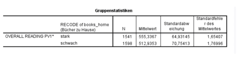

The international comparative school performance study PIRLS (Progress in International Reading
Literacy Study) raised in 2011 the reading competences of the fourth graders in more than 40 countries, mong others in Germany.
They would now like to investigate how the cultural capital of the parents affects the reading competencies of the children in the fourth class.
They operationalize the cultural capital as the volume of the books in the parents' house.
They want to find out if there is a significant difference between children whose parents have over 100 books, and children whose parents have a maximum of one hundred books.
A table of statistic is given:
where Mittelwert=mean value, Standardabweichung=standard deviation, Standardfehler des Mittelswertes=standard error of mean value. We have to compute a T-Test to find out, if we can confirm out hypothesis and to get a statistic significant relation.
First we have to prove with a F-Test, if we have to apply a double T-Test or a Test of Welch.
At the F-Test and the T-Test we have a significance level of 5 %. How can we check what T-Test we have to apply? (Wondering)
The null hypothesis is that when the parents have more than 100 books then the children are better in reading than others, or not?
Do we get from that that we don't need a double T-Test? (Wondering)
Also using the F-Test how can we check if there is an homogeneity or a heterogeneity of variance? Do we have to use this formula ? (Wondering)

Hey mathmari! (Smile)
Either way, we're going to do an independent 2-sample t-test.
The only question is how we're going to calculate the standard error SE.
That depends on whether we should assume equal variances (double t-test) or unequal variances (Welch's test).
To figure that out we'll do an F-test, for which we need to calculate the F-score:
$$F=\frac{s_1^2}{s_2^2}$$
We'll have to e.g look up in an F-table what the critical F-score is. (Thinking)EDIT: Oh, and the null hypothesis is (always): there is no difference, everything behaves as if there is nothing special. (Nerd)

I corrected the link. It holds that the variance is the square of the given standard deviation.
So, $s_1^2=64.93145$ and $s_2^2=70.75413$. Then $F=\frac{s_1^2}{s_2^2}=\frac{64.93145}{70.75413}\approx 0.9177$.
Is this correct? (Wondering)

Yes... although it seems we didn't actually square those values... (Worried)

$$F=\frac{s_1^2}{s_2^2}=\frac{64.93145^2}{70.75413^2}\approx 0.84218$$ right? (Wondering)

Right.
The degrees of freedom are respectively $DF_1 = n_1 -1 = 1541 - 1$ ($x$-axis) and $DF_2 = n_2 - 1= 1598 - 1$ ($y$-axis).
The first table is for the threshold of significance $\alpha=0.05$, which is what we will want.
When we look it up, we find the critical F-value $F^*$. (Nerd)
If $F > F^*$ or $F < \frac{1}{F^*}$, then the variances are significantly different.
Otherwise they are assumed to be equal.
Note that an $F$-value of $1$ means that the variances are exactly the same.
What is the closest $F^*$ value that we can find?
What can we say about on which side of $F^*$ our $F$-value will be? (Wondering)

We have that $\frac{1}{0.84218}\approx 1.19$ but at the table the smallest number is $1.93$. What do we do now? (Wondering)
We find another F-table, since we cannot be quite sure yet whether it is significant or not (although it doesn't look significant)...
Can we find one? (Thinking)
At this https://www.ma.utexas.edu/users/davis/375/popecol/tables/f005.html there is 1.19.
Hmm... that table gives $F^*=1.03$ for $\alpha=0.05$, $DF_1 > 1000$, and $DF_2 > 1000$.
And we had $F=1.19$, so that implies we need to assume unequal variances... (Thinking)

We have taht \begin{equation*}t=\frac{\overline{X}_1-\overline{X}_2}{s_{\overline{\Delta}}}\end{equation*} where $\sigma_{\Delta}=\sqrt{\frac{s_1^2}{N_1}+\frac{s_2^2}{N_2}}$.
We have that \begin{equation*}\sigma_{\Delta}=\sqrt{\frac{s_1^2}{N_1}+\frac{s_2^2}{N_2}}=\sqrt{\frac{64.93145^2}{1541}+\frac{70.75413^2}{1598}}= 2.42\end{equation*}
Thereofre we get \begin{equation*}t=\frac{555.3367-512.9353}{2.42}=17.52\end{equation*} right? (Wondering)
That looks correct yes. (Nod)
