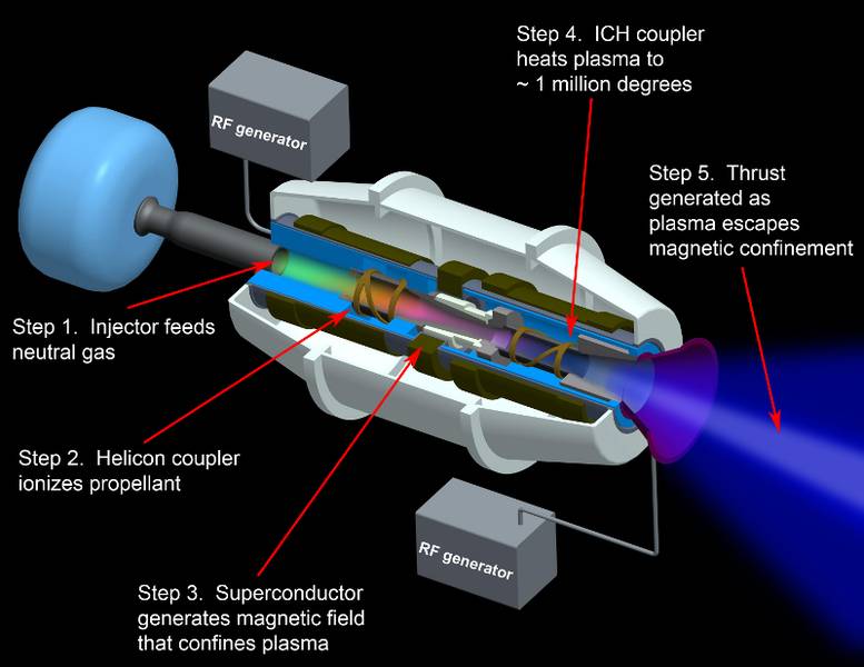

Ok, I come back again.
Thank you for the Vasimr sugestion, I were looking for a system similar to mine. My ionizer is closer to a plasma thruster due I use higher plasma density than a particle accelerator.
Is this the vasimir setup?:
My idea was to heat directly the plasma using a magnetron at 2.4Ghz. I know a japonesse scientist that uses the helicon antenna so I can speak to him to ask about. I like from helicons that I can work at few MHz and high power (I can have 40MHz and 50kW :) )
I do not understand because I think that the efficiency must be lower than 50% because thrust is done by heating the plasma 100eV instead ionizing using 10eV and then accelerate using electrostatics.
I made some tests using Lorentz but I obtained efficiencies under 14% so I am not happy with heating fuel after that
Of course. Because you attached wikipedia illustration from VASIMR page.:smile:
If you use one-step heater, your efficiency may be up to 65% which is simply nozzle efficiency. VASIMR loses additional 15% on collisions between counter-spiralling electrons and ions, and to generate RF from DC.
Regarding efficiency, may be you have too high frequency for double-layer helicon thruster. I do not know which simulator do you use though. In general, do not forget: simulators indicate the possible solution, not measure the solution.

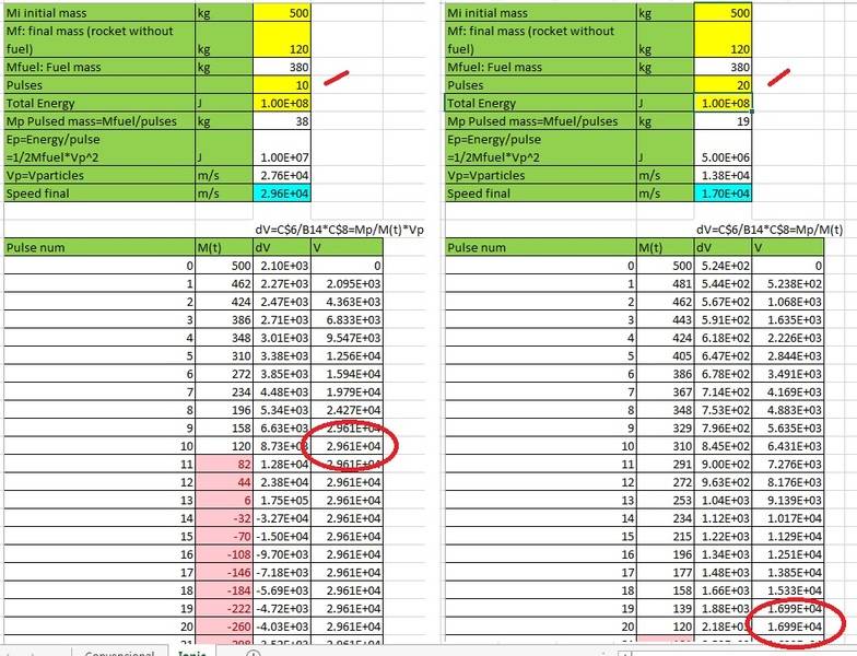

I calculated with impulse proportional to m*v, so if you send 10 times more mass you obtain 10 times more specific impulse.
So I made following calculations that could be wrong so I would appreciate if you check them
I made an excel table with theoretical data (not related to real rocket) with following results:
A 500kg rocket with 380kg fuel that uses 100 megajoules by using 10 pulses (at 100% efficiency) would be accelerated to 29.6km/s
Using 20 pulses would be 17km/s and 100 pulses would lead in 3.8km/s only:
Energy spent on acceleration of propellant is square of impulse carried by propellant. Spreadsheet above is in error.
Then I do not understand because in electrostatic acceleration E=nq*V that is proportional to number of charges, not the squared, where V is the accelerator voltage (of course the ionization energy must be accounted as losses)
And wasted energy from capacitors is V*I*t where I =n*q appears again, then, where the square of nomber of mass (or charges) come from?
It is important as long as I would like measure how many ions are accelerated by measuring the capacitor voltage drop
