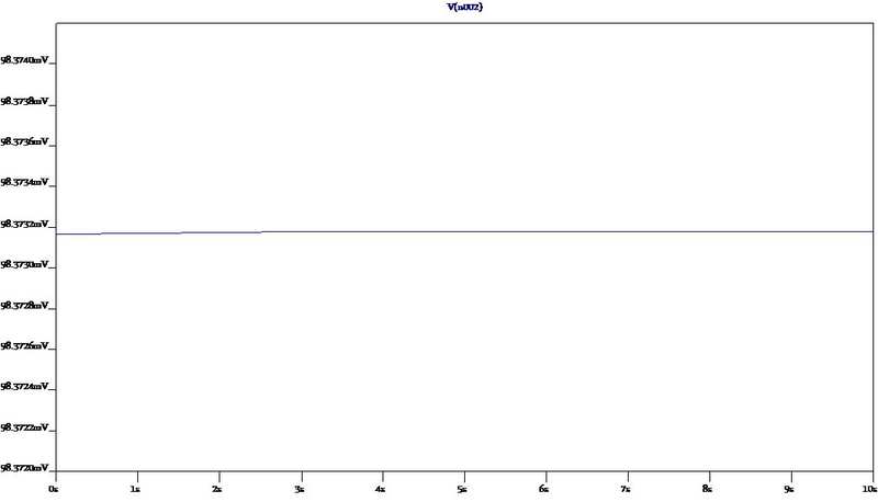

there is something strange in my lt-spice

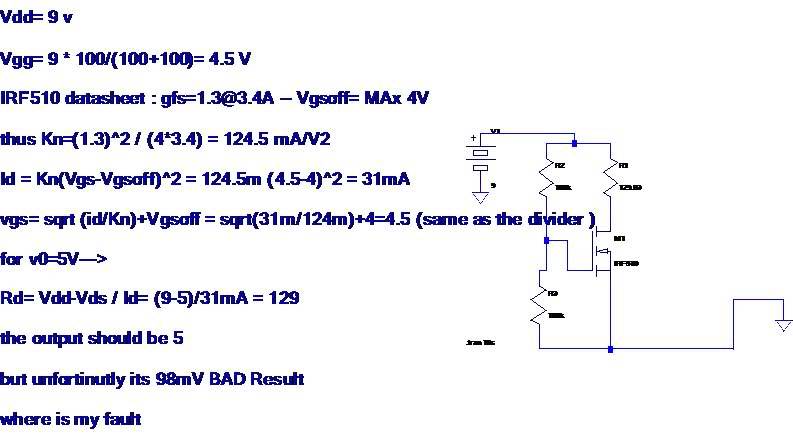

when i build my circuit mosfet with voltage divider + NO Rs (@Source Lead)
i did not get the corresponding Id current WHY?
my parameter:
R1=R2=100K
Rd=400
Id=10 mA
where i used IRF510 with Kn= gfs^2 / 4Id = (1.3)^2 / (4 * 3.4 ) = 124 mA/v2
i want to see at least V0= 1 or more than this
but unfortunately i see very small voltage on Vds about 200 mV
please some one help me

Just vary the input voltage and observe the drain voltage.
At some voltage between 2 volts and 5 volts, the FET should turn on and the drain voltage should drop.
With LTSpice, there is a feature for varying a power source.
So, if you put a voltage source across the input and vary it from 0 to 10 volts, you will see where the FET starts to conduct.
I tried it in LTSpice using an IRF510 model, and the FET switches on at about 3.9 volts.

There are variations between actual samples of FETs and what you get in LTSpice depends on the model that you are using.
You are not trying the input voltage variation I suggested and yet this is the only way to find the switching voltage. The FET will not do anything useful until you get the bias right.
The 400 ohm load resistor is too high for this FET and it results in a very critical transistion from off to on.
Having a source resistor makes the FET less critical to set up.

i wish if you supply me with the correct method on how to find the value of Kn because the datasheet not mentioned for this value ; all i know is to calculate this value like this below:
Kn= (gfs)^2 / (4 * Id)
are there any other way to extract the accurate value of Kn from datasheet ??
datasheet not mentioned Id(on) else...
When you give a formula, you need to state what the variable symbols mean.
Until you do that, anyone would just be guessing what you mean.
However, formulas giving gain etc of transistors and FETs always assume that the device is acting in a linear mode. Your FET is biased fully on and is saturated, so any formulas that assume linear mode will not be accurate.

my problem started when i was in my lab then i had build my circuit of colpitts for BJT but when i migrate to use MOSFET not JFET to achieve colpitts i successes to design it but i asked my self why not remove Re of the source leg and recalculate my values again to give the circuit 30mA with 5V output ...then suddenly i got what i do not like to guess...after that i decide to finding another way to get the correct output current of the drain using the formula which is known to us. i think the problem came from that I can not extracting Kn (constant of MOSFET) from datasheet ... why manufacturer not included in DATASHEET? series of problems i have ... so please if you can help me or give do not stop to help.
Again, you need to say what Kn is. Maybe I should know, but please define it.
What does this value affect?
Kn is the constant of Mosfet that is used in calculating the current of the drain
as this formula give: Id= Kn (Vgs - VgsThreshold )^2 where id = drain current
Can you give me an example of circuit using mosfet with voltage divider and without putting Rs (resistor on the source leg) which give me 3 volt and 10 mA ? if you do this you answer all my questions
If you have a 9 volt supply, then the top resistor in your voltage divider could be 100 K and the bottom one 50 K.
So, the voltage will be ( 50/ 150 times 9 volts) or 3 volts.
If you used 80 K as the bottom resistor in your voltage divider and 100 K as the top resistor, the voltage will be ( 80 / 180 * 9 volts ) or 4 volts.
This is very close to the right bias.
You could make the drain resistor 50 ohms, too.
