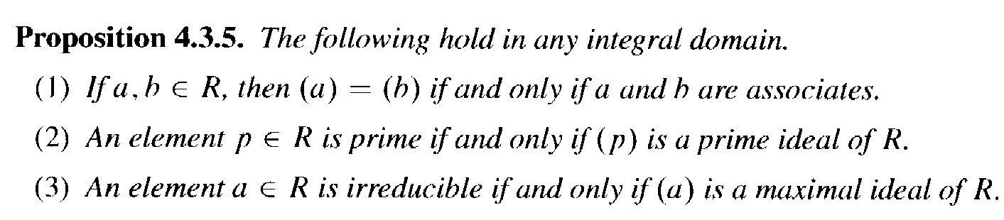

I am reading Paul E. Bland's book, "Rings and Their Modules".
I am focused on Section 4.3: Modules Over Principal Ideal Domains ... and I need some help in order to formulate a proof of Proposition 4.3.5 Part (iii)... ...
Proposition 4.3.5 reads as follows:https://www.physicsforums.com/attachments/8308
https://www.physicsforums.com/attachments/8309
Bland does not prove part (iii) of the above proof ...
Can someone please help me to formulate a rigorous proof ...

I believe that (3) is incorrect as it stands. What is true is that an element $a\in R$ is irreducible if and only if $(a)$ is maximal among the principal ideals of $R$. So (3) would be correct if $R$ is a PID. Since Section 4.3 is entitled Modules Over PIDs, maybe Paul Bland had PIDs in mind when stating the result. But in general an integral domain need not be a PID.
For a counterexample, let $R = \Bbb{Z}[x]$, which is an integral domain but not a PID. The element $x$ is irreducible in $R$, but $(x)$ is not a maximal ideal because it is contained in $\langle 2,x\rangle$, which is a larger, proper (but not principal) ideal.

I think we also have to exclude any ring with two or three elements (e.g. $\mathbb Z/2\mathbb Z$, $\mathbb Z/3\mathbb Z$). Such a ring is an integral domain (in fact a field) and a PID, but $\langle 0\rangle$ is a maximal ideal and $0$ is not an irreducible element.
Let $R$ be an integral domain that is also a PID and has more than three elements.
Suppose $a\in R$ is irreducible, and consider an ideal $\langle b\rangle$ such that $\langle a\rangle\subseteq\langle b\rangle\subseteq R$. Then $a=cb$ for some $c\in R$. As $a$ is irreducible, either $b$ or $c$ is a unit. If $b$ is a unit, then $\langle b\rangle=R$ ($\because$ for any $r\in R$, $r=b(b^{-1}r)\in\langle b\rangle$). If $c$ is a unit, then $a$ and $b$ are associates and so generate the same ideal, i.e. $\langle a\rangle=\langle b\rangle$. This shows that the ideal $\langle a\rangle$ is maximal.
Now suppose the ideal $\langle a\rangle$ is maximal. Since $R$ has more than three elements, $a\ne0$; also, as $\langle a\rangle\ne R$ by the definition of a maximal ideal, $a$ is not a unit. Let $a=bc$ for some $b,c\in R$. Then $\langle a\rangle\subseteq\langle c\rangle$; as $\langle a\rangle$ is maximal, either $\langle a\rangle=\langle c\rangle$ or $\langle c\rangle=R$. If $\langle a\rangle=\langle c\rangle$ then $c\in\langle a\rangle$ $\implies$ $c=da$ for some $d\in R$ $\implies$ $a=bc=bda$ $\implies$ $bd=1$ since $a\ne0$ and $R$ is an integral domain. Thus $b$ is a unit. If $\langle c\rangle=R$, then $1\in\langle c\rangle$ and so $c$ is a unit. This shows that $a$ is irreducible.
In fact, for any integral domain $R$ that is a PID and has more than three elements, the following are equivalent: for any $a\in R$,
  • $a$ is irreducible,
  • $\langle a\rangle$ is a maximal ideal,
  • the quotient ring $R/\langle a\rangle$ is a field.

Parts (1), (2), (5), and (6) of Proposition 4.3.5 are correct if R is an (integral) domain.
Part (3) needs the extra condition that R is a PID, thanks to Opalg
Part (4) is a consequence of part (3), so in this part, R must be a PID too.
Rotman - Advanced Modern Algebra (2003), page 322-323 confirms the statement of Opalg.
In fact, (4) holds in any integral domain, because it relies on the correct part of (3).
To be more precise, (3) states "$a\in R$ is irreducible if and only if $(a)$ is a maximal ideal of $R$". That is an "if and only if" statement, in which the "if" part is correct, but the "only if" part is not. But (4) follows from the "if" part and is therefore true.

I have the same trouble with "if" and "only if", and I'm not 100% sure that I had them the right way round in my previous comment. (Thinking)
I agree that the best way to prove that prime implies irreducible in an integral domain is to argue directly from the definitions (not using (3) at all). Suppose that $a\in R$ is prime, and that $a = bc$. We must show that either $b$ or $c$ is a unit. Since $a$ is prime and divides $bc$, $a$ must divide $b$ or $c$. Suppose that $a$ divides $b$, say $b=ad$. Then $a = bc = adc$, and so $a(1-dc) = 0$. But $R$ has no zero-divisors, and since $a\ne0$ it follows that $dc=1$. Therefore $c$ is a unit.
Thank you Opalg.
My proof, almost the same:
Suppose p is a prime element, 0≠p=ab. Then a|p and b|p. But also p|ab implying p|a or p|b. So a or b is an associate of p. Suppose a and p are associates, then p=au for some invertible u in R. R is an integral domain, so b=u, b is a unit and p is irreducible.
