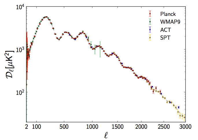

How precise does this look to you?
Actually, modern cosmology is amazingly accurate given all the assumptions and approximations used. We can estimate the masses of galaxies, clusters of galaxies, predict the spin down rate of distant stars, the temperature of intergalactic space, and a vast array of other stuff to within a matter of percentage points. Its really quite amazing to see some of these predictions validated by observation.

The primary thing you need to recognize to make sense of the various claims of discrepancy is this:
Cosmology is easy. Astrophysics is hard.
In a bit more detail, why I mean by the above two sentences is that it's comparatively easy to make measurements of things like the ratio of normal matter to dark matter, for the reason that the Cosmic Microwave Background provides an astonishingly-good measurement of that ratio (this was what the plot bapowell posted above refers to). That it, it is easy to understand this sort of thing compared to the difficulty in understanding the behavior of galaxies, and stars are more difficult to understand still.
You might think it somewhat odd that we can understand well how the whole behaves without understanding the details of the pieces that make up that whole, but consider this: it is comparatively easy to understand how a baseball behaves, but extraordinarily difficult to understand how the atoms of the baseball interact with one another. It is pretty generally the case that you don't need to understand the details of the behavior of the component pieces to get a very good understanding of the whole. And this is true with cosmology as well.
Stars are hard, because we can only ever see their surfaces and the stars themselves comprise less than a single pixel in most of our images of them (aside from our own Sun). There's a lot of complex physics that goes on within stars that is very difficult to model on a computer.
By contrast, cosmology is easy because we essentially got lucky with the behavior of physics: the CMB itself is astonishingly simple, as it is an almost perfect black body with small (1/100000) deviations in temperature from place to place acting in a regime where we can use the approximation that structure formation is linear.
