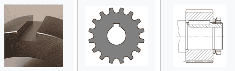

How important is it for a parallel shaft key to be ground flat? If key measures the right size but the surface isn't especially flat, will there be any negative affects?
Our company has made our own shaft keys for many years, grinding them on the 4 loaded surfaces.
For example, let's say the pulley and shaft key seats are .5005 +/- .0005 wide.
We've made ground keys that are .4995+/- .0002 with a flatness of .0004.
We now are considering purchasing keys with a tolerance of .4990+/- .0005
The keys are measuring this width in tolerance, as long as you use a calipers or a micrometer with reasonably large anvil. However, if you put a dial indicator across it, with the key on a surface plate, The needle moves about .0015". So there is waviness to the key surface, but the high points measure in spec.
My thought is that this variation has minimal affect on the shear area, so there should be little to no difference in strength or performance. However, the key will not be bearing load onto the key seat as uniformly as if they were ground keys.
Can anyone see any issue with these slightly wavey surface keys?
Pictures showing examples of key seat in a shaft, in a gear, and in an assembly.
If the slot width is 0.5000...0.5010, and the key width is 0.4993...0.4997, resulting in a gap fit. If we add 0.0015 to the width of 0.4990, we get 0.5005, that is, a normal fit or with a weak tension. If the highs are within the specification, it is unclear why the readings are 0.0015. Maybe +0.0005 on both sides and the error of the device? Personally, it seems to me that there is no problem. But in general, for such mating, as far as I know, a low-tension landing is used in order to eliminate backlash and impacts during launch
Only two sides of the key should matter.
The attached drawing shows a key which top surface must have a gap.
Are the four sides showing the measured waviness?

A key is used to fix the phase angle of a hub on a shaft. Initially, the key will contact the keyway wherever, both will deform, until a static situation is reached. Some form of clamp or taper must be provided, to lock the hub securely on the shaft.
A key should not be in a dynamic situation, that is the job of a spline. Where the sides of the key is carrying a dynamic load, it will flog out, damaging the key and the keyway.
