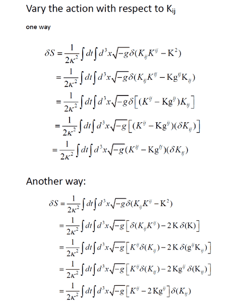

nenyan Messages 67 Reaction score 0 Thread starter Mar 21, 2015 #1 I got the result that is consist with references in fisrt case. Is there anything wrong in 2nd way?
Orodruin Staff Emeritus Science Advisor Homework Helper Insights Author Gold Member 2025 Award Messages 22,832 Reaction score 14,882 Mar 21, 2015 #2 Both are wrong. In the first case you are missing a 2 in both terms (still giving the same equation if you put the variation to zero). In the second case you missed a 2 only on the first term.

nenyan Messages 67 Reaction score 0 Mar 21, 2015 #3 Thank you. I see. Kij=gimgjnKmn I should consider another Kij here.
Orodruin Staff Emeritus Science Advisor Homework Helper Insights Author Gold Member 2025 Award Messages 22,832 Reaction score 14,882 Mar 21, 2015 #4 Yes, you cannot vary Kij independently of Kij.
