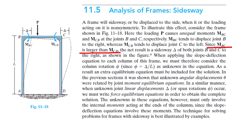

How do we know that the MBC larger than MCB ?
I think MCB is larger than MBC because the moment of P about C is larger ... So to resist moment of P about C , opposite MCB is required... Thus, MCB is larger

Yes, the diagram is badly drawn. With P near the left, I do not believe the structure would sway to the right like that. It just doesn't feel right. It would all make sense if P were to the right of half way.
Ive got a feeling they just got the subscripts wrong and it should say..
Eg with p on the left it does move to the right.
I
Looking through it again, I agree with you. Thanks.

So , the concluison now is MCB is larger than MBC ??
Yes, it's just a typo, as CWatters posted.
