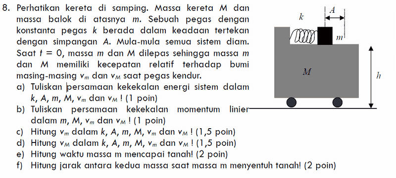

At first, the system is statics. Then, a spring with spring constant k is pressed with Δx = A. At t=0, mass m and M are released so mass m and M have relative velocity to the Earth (vm and vM)
Determine both velocity in k, A, m, M

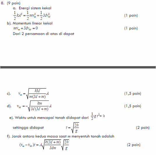

E = E'
p = p'
Actually, I've got the solution in my book.
The solution is to use the conservation of energy and momentum.
But, what I don't understand is why using conservation of momentum ?
I think the momentum is not conserved, since there is force of the spring that makes both vm and vM goes in the same direction.
I imagine it. First, the system is static (initial momentum is zero). Then, the object m and M is moving in the same direction (so, I think that the final momentum is not zero)
Please help me understand the concept of conservation of momentum

Is this the exact wording of the question?
Yes, but not instantly nonzero.
...as functions of t, or maybe of x? Or does it perhaps ask for the maximum velocities?
No, it's not the exact wording of the question. Actually, the question is written in Bahasa Indonesia. Sorry for my bad translate..
It asks the velocity in as function of A or we may say Δx
But, I've got the solution below
Conservation of Energy
0.5kA^2 = 0.5mvm2 + 0.5MvM2
Conservation of Linear Momentum
mvm + MvM = 0
From 2 equations above, we can solve for velocities
vm = √( (kM)/(m(M+m) ) * A
vM = - √( (km)/(M(M+m) ) * A
If you see anything wrong with the solution above, please tell me..
Thanks
No, the energy on the left of that equation is the initial energy, which will equal the maximum KE. But at some arbitrary time t, the total energy will involve both KE (with some lower velocities) and some PE in the spring (with less extension than A).
Looking through the list of questions in Indonesian, none of them finish off by listing "k, A, m, M". Which question is it?
It asks for velocity as a function of A
Take a look at question c and d in the Indonesian question

Yes, I looked at those, but c (for example) seems to say: "express vm in terms of k, A, M, m, vm and vM", which makes no sense.

I suggest that c and d are written wrongly. E.g. c should say "hitung vm dalan k, A, M, m dan Δx".
Apparently the small mass m is not fixed to the spring. It is launched from the cart.
I found a copy of the problem on a website and had Google Translate do its thing here.
It's the final problem on the page.

So,
0.5 k Δx^2 = 0.5mvm2 + 0.5mvM2 + 0.5 k Δx' ^ 2
Then,
mvm + MvM = 0
Then, we can solve it using two equations above.
And, I think the question to the answer
Should the question be "The velocity when the spring reached the equilibrium position ?"
I know that it will oscillate forever, but the velocity when the spring position in equilibrium ( at a very small time, because it will continue oscillating)

Possibly. Is vm = √( (kM)/(m(M+m) ) * A the answer in the book?
Thanks a lot
This is the answer in my book
So, the question is the velocity when the spring reached the equilibrium position, right ?
Hmm.. It seems I missed translating the last part of the question.. Sorry for my mistake
The 'Saat t = 0, massa m dan M dilepas sehingga massa m dan M memiliki kecepatan relatif terhadap bumi masing-masing vm dan vM saat pegas kendur.'
means ' at t=0, mass m and M are released so mass m and M have relative velocity to the Earth vm and vM when the spring is not in extension nor compression (at the equilibrium position)'
