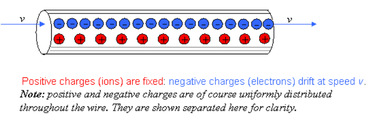

Consider an infinite wire that has no electric current initially.
Then current starts to flow in the wire, i.e. the free electron drifts at speed ##v## (and the positive charges are fixed)
Applying special relativity, it appears that the distance between the electrons shrinks, i.e, density of electron in the wire increases.
So, it seems to me that the net charge is not conserved in this case, as the negative charge density has increased.
What makes you think the distance between the electrons in their rest frame is the same?

Thanks for your reply. At first, it seemed very obvious to me. Later on, when I thought whether the distance should be same or not and why, I couldn't reason it out. Would you please give me some clue?
Your argumentation in the first post should already tell you that the distance between the electrons in their rest frame is different in the two scenarios if you want an uncharged conductor carrying a current.
However, there will be inertial frames where the conductor is negatively or positively charged. This follows from the Lorentz transformation of the 4-current.

Your argumentation assumes that this wire is infinite. This leads to a distribution of matter not going to zero at infinity and it is unclear how you want to start a current in an infinite wire (this would actually take an infinite amount of time).
Does it matter?
Yes. The way to determine the total charge would be to integrate the charge density over all of space. If the charge density is not a function which decays sufficiently fast, this integral becomes nonsense.

You didn't really specify what made the charges flow. If we assume that the charges flow because you applied a battery, and we additionally apply Maxwell's equations, we know that charge will be conserved, because a battery can't generate or destroy charges, it can only make them flow, and Maxwell's equations require charge conservation.
Applying Maxwell's equations to a current loop in free space is rather complex, it's much simpler if you have the wire over a ground plane, or some other system such as a pair of wires that acts as a transmission line. Charge will still be conserved either way, but it's a lot harder to analyze analytically what happens by applying Maxwell's equations - I don't think I've ever seen it done in the literature.
If you do do the transmission line analysis, you basically find that charge conservation does apply as expected, and that the assumption that the charges kept a constant proper distance when they started moving is wrong, at least when the charges are made to move by a battery.
It doesn't really matter whether you analyze a finite transmission line or an infinite one, but you do need to clarify the details of what makes the charges flow to analyze sensibly what happens. And you also need to consider the time element, how and when the charges start to move in a physically realilstic manner, if you want physically realistic results. Having all the charges "magicaly" start moving at the same time isn't physicall, having the charges flow as a pulse through a transmission line is.
AFAIK, if you have a current loop generated by a battery, you won't see any redistribution of charge from the viewpoint of a stationary observer, but you may and will see charge redistribution from the frame of reference of a moving observe. This is basically Purcell's analysis of the magnetic field.

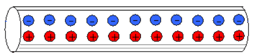

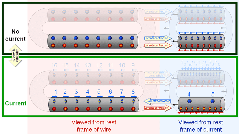

Maybe because of the length contraction effect? You can find it explained in many educational resources, for instance in http://physics.weber.edu/schroeder/mrr/MRRtalk.html where they say
Here it's the negative charges in the wire that are moving to the left. Because they're moving, the average distance between them is length-contracted by the Lorentz factor.
OK, in the picture posted by the OP the electrons are moving to the right, but this should not make any difference.
Fantasist said:

May I take it that you didn't re-read posts #2 and #4 as I recommended in the bit of my post that you didn't quote?
The point is that when no current flows, the electrons are at rest with respect to the wire, and are 0.1nm (for the sake of argument) apart in the rest frame of the wire. When the current flows, the electrons are moving. Unless electrons have appeared from nowhere they must still be 0.1nm apart in the rest frame of the wire. All that means is that they aren't 0.1nm apart in their own rest frame. But why should they be? They don't form a solid body held together by internal forces. They can be whatever distance apart they like and accelerated bodies don't necessarily end up the same distance apart in their final rest frame as they were in their original frame.
Read the reference you cited. Nowhere does it use length contraction to claim that the wire is charged in the lab frame. It uses length contraction, plus the fact that the wire is not charged in its rest frame, to show that it is charged in other frames.
Let's think about train cars instead of electrons. You start with this situation:
Code:
Then you make all of the cars in the top line accelerate to a high speed simultaneously w.r.t. the initial frame. This contracts them each individually:
Code:
                      --- moving right FAST ---->
                still stopped
If we then transform into the frame of the now-moving cars, we get this:
Code:
                at rest w.r.t. current frame
                      <---- moving left FAST -------
The reason that the top cars are more spread out in the second frame than they were when at rest in the starting frame is that, in the second frame, they did not all start moving simultaneously. The ones further ahead accelerated earlier. The reason that the bottom cars are bunched together, instead of being contracted individually, is also because of simultaneity changes.
The same logic applies to the wire and the electrons. If the charges all start moving at the same time in the starting rest frame, then the electrons *individually* contract instead of globally contracting and bunching up. (One potential area for confusion is if you imagine a battery at one end turning on to push charge down the wire. In that case the charges won't start moving simultaneously, and there will be bunching up.)

Fantasist said:
you can read off that the velocity v of the current corresponds to a relativistic factor γ(v)=4
Wherever there is an arrow labelled "Lorentz contraction" in the diagram there is a factor of [itex]\gamma_1 = 2[/itex] . I don't know where you got 4 from. The single arrow labelled "more Lorentz contraction" is a "double" contraction, with a factor of [itex]\gamma_2 = 2 \gamma_1{}^2 - 1 = 7[/itex].
Fantasist said:
The question is how do the electrons 1,2,3,6,7,8 manage to get instantaneously from the bottom section of the loop to the top section as soon as the Lorentz boost is applied.
That's due to relativity of simultaneity; the boost redefines what is "simultaneous".
8/2=4
Yes, 7 is what follows from the drawing for the second contraction (14/2) , but it should be 31 if you apply the equations of relativity
