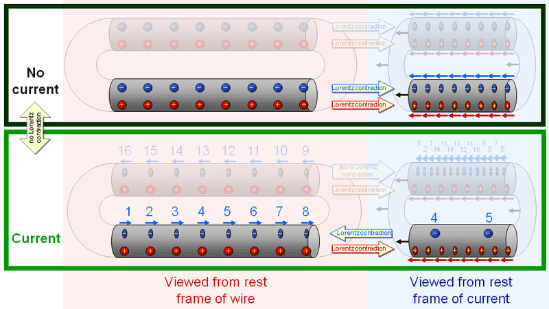

I think, if I interpret you correctly, you want to know why isn't the distance between the moving electrons contracted relative to the distance between the previously stationary electrons (all in the wire rest frame). Well, why should it be contracted? The argument above shows it isn't contracted. My guess here is that you have misunderstood what Lorentz contraction is. Lorentz contraction occurs when two different frames are used to analyse the same situation. It doesn't occur when one frame is used to analyse two different situations.
The misunderstanding occurs because we often consider the distance between two things rigidly connected. In that special case it's possible to show that a rigid object accelerated from rest gets shorter. This only applies to rigid objects. However, in our case we have freely moving electrons not rigidly separated, so that special case doesn't apply.
My question is, when current is flowing, how are the electrons not length contracted from the moving observers frame if the wire as a whole is?
I believe it's necessary [as depicted in #27, thanks Dr Greg!] to take into account that the current flows in a closed loop. Either a circular loop, or easier to analyze, a rectangular loop. In a frame moving along with the flow, the electrons on one side of the rectangle appear at rest and are not length contracted. However the ones returning on the other side have a different rest frame and do appear to be length contracted.
In the moving observer's frame the electrons are at rest, so their separation in that frame is greater than their separation in any other frame (i.e. in other frames their separation would be length-contracted compared with the frame in which they are at rest).
See my diagram in post #27 (which also illustrates Bill_K's point in post #56).

At 1:15 he applies a boundary condition of equal positively and equal negatively charged particles, sitting there at rest relative to the man. Then suddenly, and perhaps a bit too casually, at 1:27, he replaces this boundary condition with an entirely NEW one where the negatively charged particles are now moving relative to the man. Then he makes a huge point at 1:38 about how something that wasn't moving in reference to him now is, and accelerates the cat.
He didn't do anything like that at 1:27. Instead he sort of jumped into another lab down the hall, presumaly in the interest of reaching a broader audience.
If I get it right and am not just confusing matters, if the wire at 1:24 was the same wire at 1:17 then at 1:17, it should have had a positive charge because the negatively charged particles would have been spaced out and therefore fewer in number. Once they started moving in reference to the man, they would experience contraction, and the charge would subside, at 1:27. Then the cat moves relative to the man at 1:38 and relative to the cat, there's an equal charge acting on it, pushing it away.
The point is that the gap between the electrons does not contract, not from the point of view of the man in the lab at rest with the wire and not from the point of view of the cat co-moving with the electrons when the current is flowing.
The gap between electrons in the lab frame is the same whether or not the current is flowing. Imagine the electrons are initially at rest wrt to the lab and the wire and then accelerated slowly and progressively along with the cat so that the cat is always alongside a given electron. If the cat has a ruler that initially extended from its electron to a neighbouring electron, it would see the gap between the two electrons progressively getting larger relative to its ruler which retains its proper length. In the lab/man/wire rest frame the gap between the electrons remains constant and the ruler being carried by the cat is length contracting. This is a bit like the Bell's rocket paradox, whereby when the gap between two accelerating rockets remains constant relative to an inertial reference frame, the gap is increasing according to an accelerating observer on board one of the rockets.
Technically length contraction still applies. The gap between two electrons, as measured by the man in the rest frame of the wire, is always less than the gap measured by the co-accelerating cat when the current and cat are moving relative to the wire.
Lets say the loop of wire consists of 2 parallel wires (A and B), each 600m long and ignore the length of the connecting sections at each end. Let's also say there are 200 electrons in the entire circuit so they are 6m apart from each other, when equally spaced out and at rest with the wire in the wire/lab rest frame. (Yes, I know that is unrealistic but stick with me ;)
When the current is moving relative to the wire/lab, there are still 200 electrons distributed around 1200 m of wire as measured in the lab so the gap between electrons is still 6m as measured in the lab.
Now let's say the cat and the current are moving to the right at 0.8c relative to the wire/lab and the cat is at rest wrt to the electrons in wire A. (Again unrealistic, the electrons only move at something like walking pace). The gamma factor is 10/6 at 0.8c so the wire A is 360m long according to the cat. The gap between the stationary electrons in wire A is 6m*10/6 = 10m according to the cat. The number of electrons in wire A is 360/10 = 36 (according to the cat).
Now we have to find room for the other 164 electrons. To the cat the length of wire B is 360m (same as the length of A to the cat). The electrons are moving at 0.8c relative to the wire and the wire is moving at 0.8c relative to the cat, so using relativistic velocity addition the electrons in wire B are moving at (0.8+0.8))/(1+0.8*0.8) = 0.97561c relative to the cat. The gamma factor at that velocity is 4.5555 recurring. The gap between the electrons in section B is 10m/4.5555 = 2.19512195m (according to the cat).
The 360m of wire B, divided by the inter electron length 2.19512195 equals 164, so our remainder of electrons fits nicely into the return length of wire (from the cats point of view).
To summarise the case when the electrons are moving relative to the wire, from the point of view of the cat co-moving with the electrons in wire A, there are 100 positive charges and 36 negative charges in wire A and 100 positive charges and 164 negative charges in wire B, so the cat is repelled from A and attracted to wire B.
