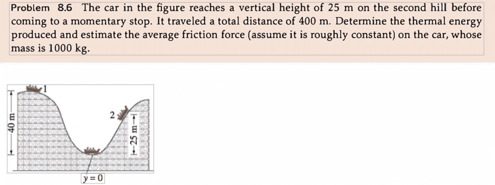

The car in the figure reaches a vertical height of 25 m on the second hill before coming to a momentary stop. It traveled a total distance of 400 m. Determine the thermal energy produced and estimate the average friction force (assume it is roughly constant) on the car, whose mass is 1000 kg.
Wnet=Wc+WNC
I am a bit confused. My teacher solved this problem and his answer for the thermal energy produced was -147,000J. My book says it is 147000J. My teacher used the equation K2+P2=K1+P1+Wnc and my book used K1+P1=K2+P2+Wnc.
Which one is it?

Friction force has opposite direction to velocity of car so
W:work which friction force does on the car has negative sign.
[tex]W=\int \mathbf{F}\cdot \mathbf{v} dt < 0[/tex]
P1+W=P2 so P1> P2. The car stops at lower position. You observe car energy change.
Q:The thermal energy floor got by giving minus work
Q=-W > 0
P1=P2+Q
You observe car and floor energy conservation.
You may choose to use negative W or positive Q of same amount.
Total energy does not change, ##\Delta E_{total}=0##. From the starting point at height 40 m to the final height of 25 m the only energy changes are gravitational potential, ##\Delta U_{grav}## and thermal, ##\Delta E_{therm}##. Thus, $$0=\Delta E_{total}=\Delta U_{grav}+\Delta E_{therm}~\Rightarrow~\Delta E_{therm}=-\Delta U_{grav}.$$Now $$\Delta U_{grav}=mgh_{\text{f}}-mgh_{\text{i}}=mg(h_{\text{f}}-h_{\text{i}})=1000\times 9.8(-15)~\text{J}=-147,000~\text{J}.$$Thus, ##\Delta E_{therm}=+147,000~\text{J}.## The thermal energy increases which makes sense because the track's and the car's temperatures rise.
Note: Here we considered a three-part closed system consisting of the car the track and the Earth.

The question specifically asks for the ‘thermal energy produced’ (Q). This will be a positive value.
The work done by friction (W) will be a negative value, because friction and displacement are in opposite directions. A negative value for W tells us that friction has removed mechanical energy.
In this problem: Q = -W.
Friction has removed 147,000J (hence W = -147,000J). What has friction done with this removed energy? - it has converted it to thermal energy, so thermal energy produced = +147,000J.
Personally I would use:
P1 + K1 + W = P2 + K2 (remembering W is negative here and Q = -W)
