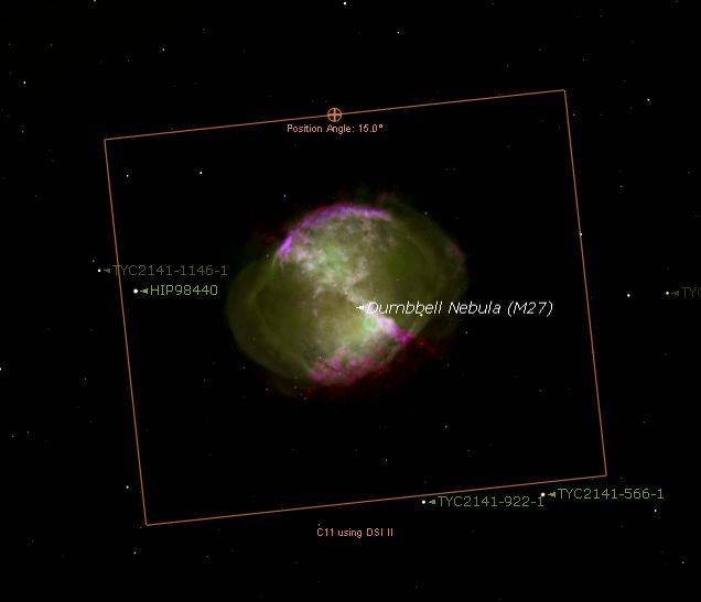

Anyway, tony's method is what I use for estimating magnification of my images. I measure/estimate a viewing distance from my monitor, a dpi and a resolution of the image to come up with an angular diameter of the image. I then divide that by the angular diameter of my subject.
Magnification is nice to know because lay people ask it all the time, but of much more importance when taking most photos is field of view. It's how you know you can have your subject well framed in the imager. I use Starry Night, which has a fov utility that draws a box around objects in the program to estimate the fov of my equipment.
[edit] As a matter of fact, this is what my telescope is imaging right now (that's Starry Night's image, not mine):
Russ, just a question, how do you change the desired magnification with the Dsi camera? with the Barlow Lens ? I know that as much of the ccd the image occupies more the resolution. But i don't think that choosing between a 1.5x 2x and 3x barlow is very practical or precise for photography. how do you do that?

You use a barlow or a focal reducer. You can also move your camera towards or away from the focal recuer or barlow to change the amount of reduction or increase in the focal length. But no, there is no way to finely adjust the focal length like with a telephoto camera.
