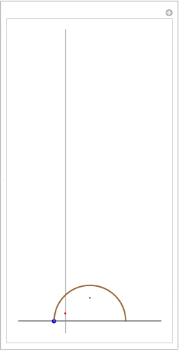

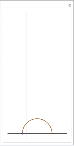

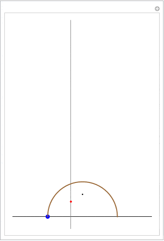

I attempted to use Mathematica to numerically solve the equations of motion and generate some animations.
The tube is represented by a semicircle. I varied the mass ratio M/m, where M is the mass of the tube and m is the mass of the ball. The animations start at the instant the particle enters the tube on the left.
Here is the choice M/m = 2
The ball makes it all the way through the tube. The final angular velocity of the tube is zero. I found this to be the case whenever the ball makes it all the way through the tube. The red dot is the center of mass of the system. The small black dot is the center of mass of the tube.The next case is for M/m = 1/3.
Now the ball does not make it all the way through the tube. It exits the same end of the tube in which it entered. The final angular velocity of the tube is not zero.There is a critical value of the ratio M/m equal to ##\large \frac{4\pi-\pi^2}{\pi^2-4} \normalsize\approx 0.46## where the ball gets stuck at the apex of the tube.
Of course, all of the above depends on the correctness of the equations of motion and the programming.

Here are the trajectory paths for the case where M/m = 2 using the output of Mathematica. The initial and final trajectory lines all intersect at one point.
