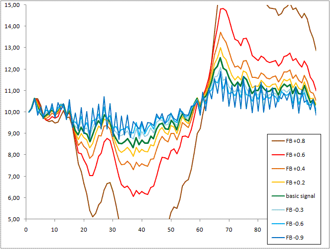

Curiously enough Vanesh explains about feedback in relation with climate.
For information: feedback is a general technique where the output of a system is sampled, compared to a desired output, and a corrective input is given which should give a change in output in the opposite direction as the measured distance. The whole theory of feedback is about how to determine the amount and timing of this corrective action.
However in our atmospheric feedback processes there is no desired output. the chaotic movements are not controlled. There are only forcings (sun, ocean, etc) that may or may not be affected by feedbacks but always with a certain delay, since these processes take time. These feedbacks act on the rate of change in the process, negative feedback would counter it, positive feedback would enhance it.
So we could make a chaotic random model with a random walk and put various feedbacks on that to see how it changes the original chaotic signal. That is done here,
The green signal in the middle is a plain one dimensional random walk. Each next step being at random between +0.5 and -0.5. For the blue graphs the indicated fraction of the former step is subtracted from the next step, simulating negative feedback with one step delay. For the warm colors, orange - red - brown graphs, the indicated fraction of the former step is added to the next step to simulate positive feedback.
As expected the blue negative feedbacks resist steps away from the starting position while the reddish positive feedbacks 'amplify' it.
But there is more. The positive feedback graphs are smoother than the original green signal while the negative feedbacks show an increasingly strong ripple or noise. Obviously the positive feedback opposes direction up/down changes, simply because if the signal changes direction, for instance, from plus to minus, the feedback of the former step is still in the plus mode, attempting to continue in the plus direction (persistent). This results in less direction changes than the original signal. In contrast the negative feedback was already going to resist the positive former stap with a negative factor, so the direction change is assisted and amplified, therefore the negative feedback comes up with more direction changes than the original signal (anti-persistent).
This effect is what Kärner uses in his publications, he analysis the various records on persistency, to see how the changes in heading are. Apparantly these were frequent enough to suggest negative feedback.
The uploaded zipfile contains the excel worksheet that produced the graph. It's on manually calculating, to produce all kind of artistic results. It also calculates the number of heading reversals to see that no feedback is around 50(%) Strong positive around 20-30% and strong negative around 80-90%
