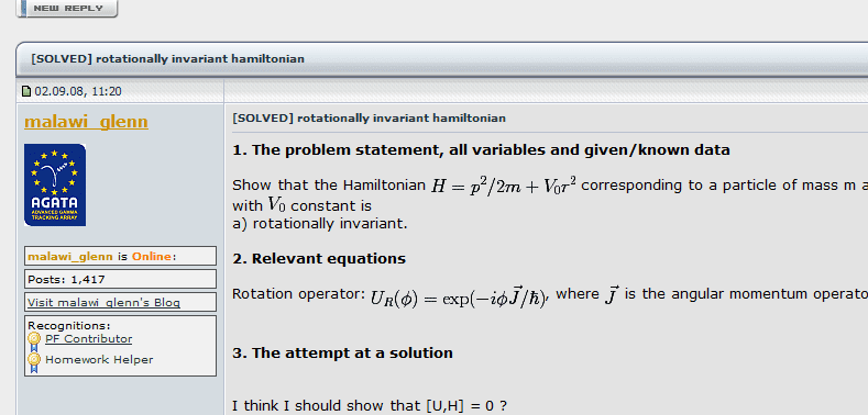

Show that the Hamiltonian [tex]H = p^2/2m+V_0r^2[/tex] corresponding to a particle of mass m and
with [tex]V_0[/tex] constant is
a) rotationally invariant.
Rotation operator: [tex]U_R(\phi ) = \exp (-i \phi \vec{J} / \hbar )[/tex], where [tex]\vec{J}[/tex] is the angular momentum operator.
I think I should show that [U,H] = 0 ?
Or is it [J,H] = 0 ?
