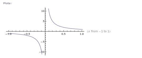

if someone ask me that i will draw
and say it is the area above the x-axis minus below x-axis
