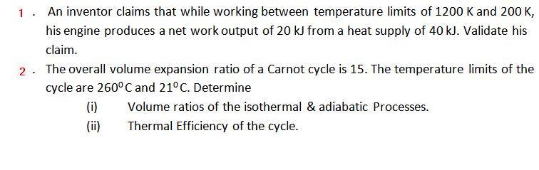

Hi
Can please give me the idea for solving these questions
Printed homework text listing two thermodynamics problems: an inventor's engine claim between 1200 K and 200 K with 20 kJ net work from 40 kJ heat, and a Carnot cycle with volume expansion ratio 15 and limits 260 C and 21 C asking for isothermal and adiabatic volume ratios and thermal efficiency.
I have efficiency = 1 - Tlow /T high
so 1 - 200/1200
efficiency = 5/6
Carnot efficiency = w/Qh
20/40 = 0.5
then what the next ?
Why is the Carnot efficiency important? Can a given process have a greater efficiency than the Carnot value?
hi
I don't no the important but I can not the efficiency greater than the Carnot value
So, based on the Carnot efficiency of the process, and the efficiency determined by the heat input and work output, is the process feasible?
BTW, if you read the wiki article, it tells you why the Carnot efficiency is important.
