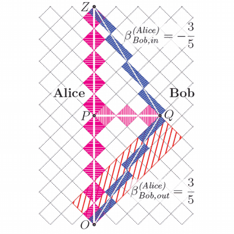

Yes, the article looks correct... and, as others have pointed out, it uses a Doppler approach (although not fully following Bondi's k-calculus treatment since it appeals to length contraction. [Bondi was quoted at the top of the article.]).
Note the clock comparisons are "visual comparisons of clockface readings", which involve the Doppler factor (k=2 for v=(3/5)c).
(The more typical textbook comparisons use "time dilation", which involve the time-dilation gamma factor ([itex]\gamma=5/4[/itex] for v=(3/5)c).)
Here's the spacetime diagram shown in the SciAm article
(which I pasted here because I couldn't easily see it in my browser..(maybe a pop-up blocker is running?) I had to manually build the URL).
Here is my version of the diagram (taken from my PF Insight https://www.physicsforums.com/insights/spacetime-diagrams-light-clocks/ ),
where each diamond would represent two ticks in the article's setup.
The diagram includes enough data that can be used with practically any explanation that works [including an arc-length calculation of proper time].
To see the apparent distance "4.8" in the article (which would be 2.4 on my diagram above), one has to draw a line parallel to Bob's space-axis (the spacelike diagonal of his diamond), then construct Bob's diamonds along it.
I've drawn it below in full-scale [so the homebody interval is 20 and the distance is 4.8].
