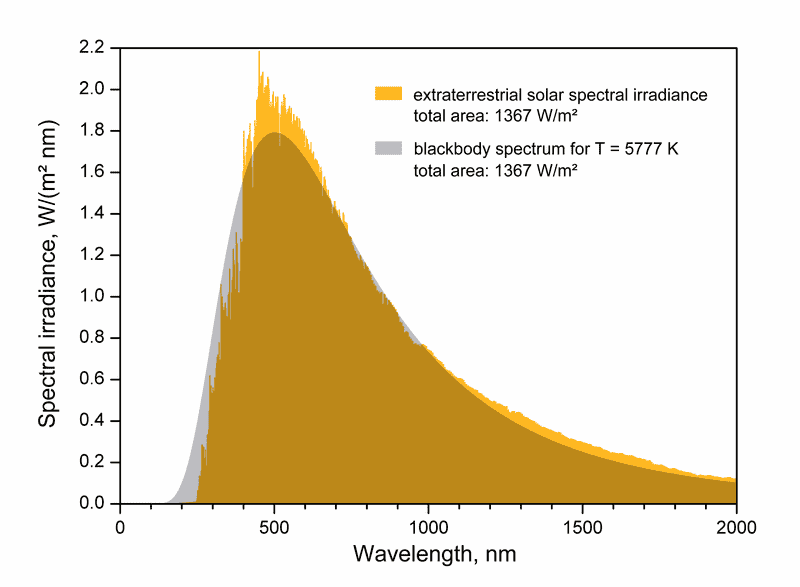

Can't we use temperature to predict luminous intensity, then compare that to actual to find emissivity?
See:
https://upload.wikimedia.org/wikipedia/commons/0/0d/EffectiveTemperature_300dpi_e.png
@Young physicist I think the curve that @russ_watters presents above would also give reason to believe that the surface of the sun is "approximately" a blackbody without any spectral reflectivity measurements. It would be rather unlikely that the surface would have a nearly constant emissivity/reflectivity independent of wavelength for such a wide spectral range unless that emissivity was quite near 1.0.

Anyway, the one I posted seems just a touch off point. The total area [average irradiance] appears to have been purposely set equal, but the sun's graph looks clearly shifted to the right, indicating the temperatures don't match. I suggested the opposite: match the temperatures, then compare the areas to find the emissivity.
Googling, I find values around 0.985.
Seems pretty close to blackbody to me.
