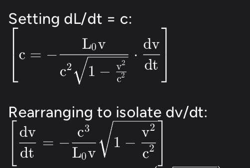

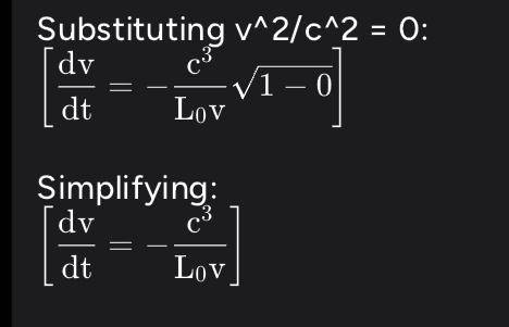

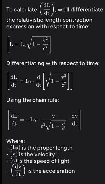

Hello, I am new to the forum. First, since now, a deep thank you for your patience with my amateur views. This question just popped up after doing the time derivative of the relativistic length contraction, and assuming that the maximum length change in time would be the light velocity. After considering that the object velocity is << light velocity, the result is that there is a maximum acceleration that is inversely proportional to the object size and velocity. Doing something wrong?
There is no maximum acceleration in relativity.
Your attachments haven't worked, but you mention object size. Relativity does make it impossible to consider rigid objects under a limited range of circumstances (inertial motion, or constant and eternal rotation or Rindler acceleration, basically). It's possible you've tripped over that, and you may want to look up Bell's spaceships for a textbook demonstration of this.

Hi Ibix, fixed the attachments. Thank you for your comments. The point is that applying the length contraction expression for low velocity objects, would result in an acceleration limit.
You cannot use length contraction for such an argument. Length contraction in its normal form applies to objects moving at constant velocity. Going away from that you need to look into what has already been mentioned in this thread: Bell's spaceship paradox and Born rigidity.

If we consider a single particle, there is no limit to its acceleration. You can see this by considering an electric field of arbitrarily large strength acting on a charged particle. Before you go any further, you must see that, by this simple example of a charge particle in an electric field, relativity specifies no maximum acceleration.
Therefore, your conclusion is clearly wrong. The question is why is it wrong? I've provided some analysis above. In a nutshell, it's the relativity of simultaneity - as it often is. It's a common mistake to forget about the relativity of simulateity and find a paradox in SR by using only length contraction and/or time dilation.
As was mentioned above, the length contraction formula assumes an inertially moving object. It doesn’t apply for accelerating objects.
In general, if a formula is derived using some assumption, then it cannot be used in a situation where that assumption is violated. At least, not without some careful justification (typically done by calculating the magnitude of the error introduced by using the assumption)

The relativity of simultaneity is the big issue with using the inertial length contraction formula for an accelerating objects. In the derivation you assume that the distance between the endpoints does not depend on time. That is only true in both frames for an inertial object.
Arend said:
... after doing the time derivative of the relativistic length contraction, and assuming that the maximum length change in time would be the light velocity.
Relativistic length contraction relates the lengths of an object in different frames, not at different times during acceleration. You can accelerate an object without any change of its length as measured in its initial rest-frame (if the material is stretchable enough).

Yes. The length contraction formula is derived under the condition that ##v## is strictly less than ##c##. Thus you cannot make that substitution where you set ##v=c## in that formula.
