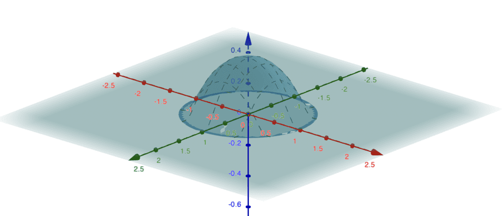

Per the wikipedia page, the bump function is $$f(x,y,z)=e^{-\frac{1}{1-x^2-y^2-z^2}}$$ or $$f(r)= e^{-\frac{1}{1-r^2}}$$ in polar coordinates
over the domain defined by the unit disk and ##0## else.
Here is a graph of the case when ##f(x,y)=e^{-\frac{1}{1-x^2-y^2}}##
A confusing aspect of this assignment is my professor asks us to plot the graph of the case ##f(x,y,z):\mathbb{R}^3\rightarrow \mathbb{R}##.
I wonder if he wants me to imagine an inventive way to illustrate the graph, explain why it is not possible, or maybe discover the ##4^{th}## spatial dimension using my portable pocket particle accelerator?
One interesting thing to note is that since all the derivatives at the boundary need to be 0, whatever function you are using inside the ball, it cannot be analytic (i.e. cannot be equal to its Taylor series locally at the boundary, since that Taylor series is identically zero).I have no idea how you are supposed to graph a 3d function.
