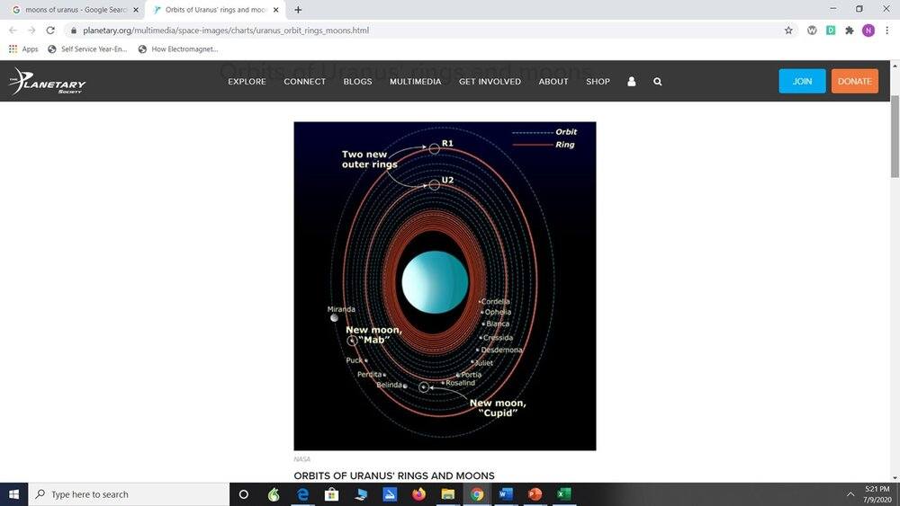

For example, the moons of Uranus below will never be behind the planet, unless, like you say, every so many decades when the planet's orbit is just right in some extraordinary way.
The other extreme, is that of Jupiter's moons, which, because Jupiter rotates so coplanar to the elliptic, its moons go behind Jupiter half the time (very generally).
My guess is that the consensus is that
Triton orbits Neptune more similarly to how the moons of Uranus orbit Uranus than how the moons of Jupiter orbit Jupiter.
Is this correct?

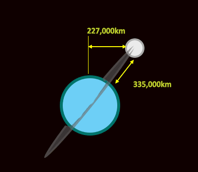

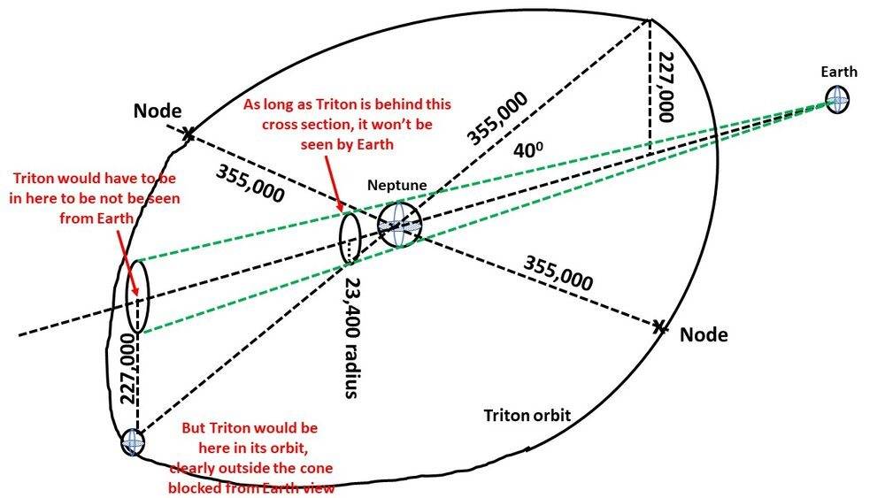

I attached a picture of what I was thinking. I drew it out, crudely and it seems like Triton would never be blocked by Neptune as seen from Earth. I followed the post up until
"I should think that Neptune must be at most arcsin(23 400/227 000) from Titan´ s node. Which I get to be about 5,9 degrees."
I do see that the sine of 23 400/227 000 is 6 degrees, but I can't visualize what triangle this in this context. I may not have the nodes in the attached picture in the correct place from the nodes you mentioned in the reply.
Yes, you are correct about ignoring flattening, etc.

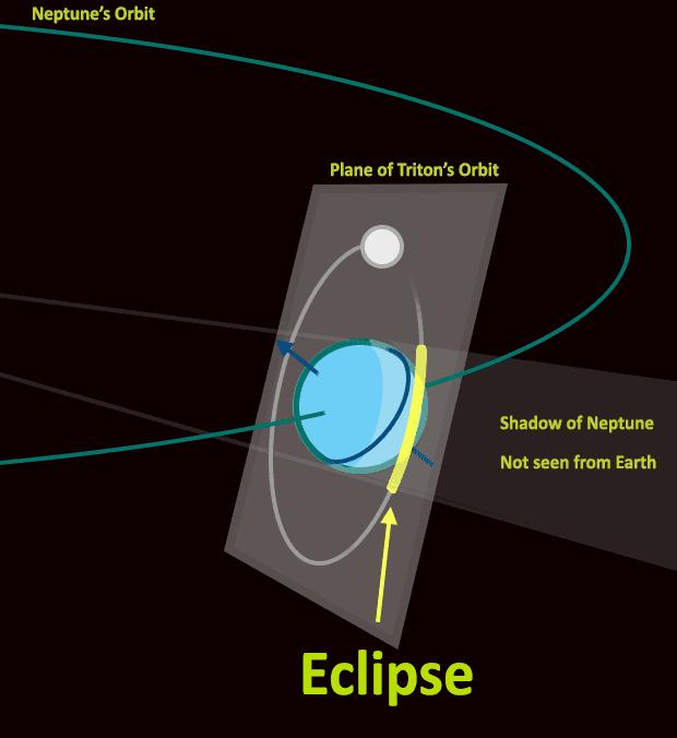

The point is that the plane of Triton's orbit is fixed with respect to the fixed stars. At some point during Neptune's orbit that plane is edge-on to us, and it is possible for Triton then to be behind Neptune.
This about right? Did I miss anything?
Boy it's really hard to represent multiple overlapping shapes in 3D...
Diagram of Triton's orbit around Neptune showing two positions of the orbital ellipse, with Neptune, Triton and the Sun marked; a yellow label reads 'Eclipse' near the right side where the orbital plane passes behind Neptune.
Oh, I see. I'm glad I posted a picture. The way you have it, DaveC426913, Triton certainly can pass behind Neptune. I didn't even think Triton could orbit that way, as evidenced by my drawing that was wrong. I did try to make Neptune and Triton orbit to scale.

In fact, even my first pic is trying to take in too much. Here is a zoomie of the right side of the first pic.
Diagram of Triton's orbit around Neptune, shown as a tilted plane with Neptune's orbit around the Sun above it; Neptune's shadow extends right, labelled 'Shadow of Neptune, Not seen from Earth', and an arrow marks an 'Eclipse' point.
The key to the whole thing is to keep in mind that nether Neptune's rotational axis nor Triton's plane of orbit change as they revolve about the Sun. Just like Earth, Neptune has its own Pole Star (theoretically) in the fixed background of stars, as does Triton's orbit.
At two points in Neptune's orbit about the sun, Triton's orbit about Neptune is seen edge-on. That's when Triton passes behind Neptune from Earth's PoV.
*nb" I have used the word eclipse sloppily. Should really be occultation.
Thanks! It is useful to explain my points, though I do not want to alter your drawing myself.
The point is that the direction Neptune-Earth relative to the orbit of Triton changes with orbit of Neptune (and of Earth).
Sometimes they are, sometimes they are not.
Or rather, Earth is sometimes at one place relative to nodes, sometimes at another.
You depict the situation at antinode, where Triton passes at the maximum distance (227 000 km) from Neptune.
Now imagine situation one quarter of orbit - 41 years - later, where the direction to one node is precisely the direction to Earth.
Then we see Triton´ s orbit as a circle exactly edge on - a straight line which is tilted 40 degrees to Neptune´ s orbit but goes precisely behind the dead centre of Neptune. Where Triton is duly hid behind Neptune. Note that the ends of the straight line are still 227 000 km from Neptune´ s orbit, but the centre of the line goes through centre of Neptune.
And now imagine the situation where the direction to Earth is near but not precisely the direction to node.
A circle seen nearly but not exactly edge on is a narrow ellipse. Narrow enough that the narrow middle of the ellipse fits behind Neptune´ s disc.
Consider the limit - where Triton grazes just under the edge of Neptune´ s disc.
5,9 degrees is the angle between the direction Neptune-node (where Triton passes behind the dead centre of Neptune), along the plane of Neptune´ s orbit, to the direction where Triton is seen in grazing occultation.

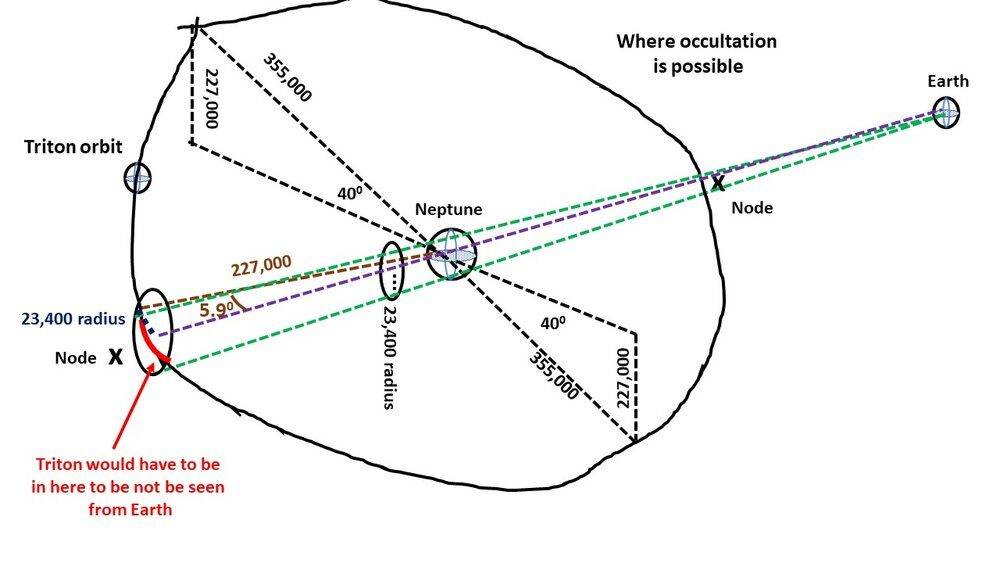

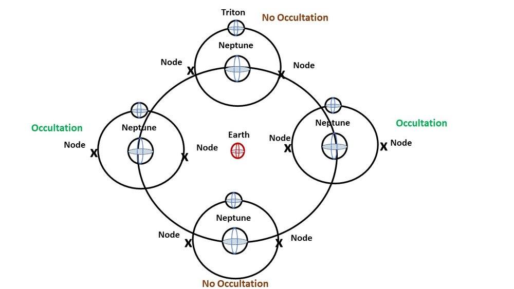

I made two more pictures, and I think I am finally seeing better what Dave’s pictures represent. Slide 2 shows the position I think that Snorkack is getting out where occultation is possible; Slide 3 is my own attempt to make a drawing that coincides with Dave’s pictures.
Slide 2 below
Diagram of Triton's orbit around Neptune as seen from Earth, with an elliptical orbit labelled 'Where occultation is possible', dashed sight lines and labelled distances 355,000, 227,000 and 23,400 radius, plus angles 40 degrees and 5.9 degrees.
Slide 3 below
Diagram of Triton's orbit around Neptune viewed from above, with Earth at the centre and four positions of Neptune around it. Labels read Triton, Neptune, Earth, Node, Occultation and No Occultation, with X marks at the orbit nodes.
I realize that one of the mistakes that I made was to assume that the anti-node orbit where occultation is not possible was always facing Earth. I see what Dave’s pictures mean now – trying to draw it out on my own – that Triton’s orbit is fixed with respect to Neptune. As Neptune goes around the center of the solar system, I see that how Earth views Tritons orbit is what changes and provides Trition’s occasional occultation from earth.
Slide two also shows my attempt to draw out the triangle that gives the 5.9°. Still does leave one question, though: if the radius of Triton’s orbit around Neptune is 335,000 km, should not that distance be used instead of the 227,000 km to make the triangle that gives the angle?
When Triton's orbital plane is edge-on to our line of sight, the tilt of its plane is irrelevant - so: yes, use the 335,000km distance.
Diagram of Neptune in blue with a dark tilted ring plane, and the moon Triton shown at upper right; labels read 227,000km horizontally and 335,000km along a diagonal line to Triton.
But the question was about making the triangle.
355 000 km would be the appropriate number if sine of the tilt were 1, so tilt is 90 degrees. Like Uranus´ satellites are close.
Compare satellites of Jupiter. When are they not occulted by Jupiter?
Callisto orbits at distance 1 883 000 km from Jupiter.
But the inclination of Callisto´ s orbit is just 2 degrees to ecliptic.
Meaning Callisto only ever gets something like 66 000 km from Jupiter´ s orbit. Even at antinode, Callisto is not far enough to pass around rather than behind Jupiter.
We have node (where the satellite´ s orbit is edge on and the satellite always passes behind planet), and antinode (where satellite passes at maximum distance, which can still be quite close). So what we are looking for is the point where the satellite just grazes the planet,

Eh, OK. I guess I didn't follow what the OP was doing.
Rings of Saturn might be easier to visualize. Sometimes the rings are big fat and glaringly obvious in a telescope (Galileo said Saturn "had ears"). Sometimes you look edge on and they rings effectively disappear in a normal backyard telescope. Triton is a planet instead of a disc but it is orbiting in a plane. We should see the orbital plane edge on twice per Neptune's orbit around the Sun.
