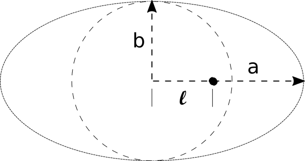

To study tidal locking (resonance), I wish to model the moon (ellipsoid) as a dumbbell of length, L.
What is a proper length, L, for the dumbbell?
Centroid of half-ellipsoid is 3/8a, half-sphere is 3/8r. A sphere (moon) would produce no torque, so these values seem incorrect.
I think the primary effect is due to actual density fluctuations (mascons) in the nearly circular moon. I believe the actual shape of the moon is pretty much the usual oblate spheroid slightly flattened at the poles. Post what you find out.
Subtract the sphere from the ellipsoid - the dumbbell is the remainder.
The equation for the ellipse is ##x^2/a^2 + y^2/b^2 = 1##, ##a>b##, and the equation of a sphere is ##x^2 + y^2 = b^2##, of radius b. We find the centroid, ##\overline{x}##, for half the volume as follows:
\begin{align}
\int{x dV} &= \pi \int{x y^{2}dx} = \int_{0}^{b} [\frac{b^{2}}{a^{2}} (xa^{2} - x^{3}) - (xb^{2} - x^{3})]dx\nonumber \\
&\qquad \qquad \qquad+ \int_{b}^{a}\frac{b^{2}}{a^{2}}(xa^{2} - x^{3})dx \nonumber \\
&\qquad \qquad\qquad\quad \quad= \pi \frac{b^{2}}{4}(a^{2}- b^{2}) \\
\int{dV} &= \frac{\pi}{2}(\frac{4}{3}ab^{2} - \frac{4}{3}b^{3}) \;= \pi \frac{2}{3}b^{2}(a - b) \\
\overline{x} &= \int{x dV} / \int{dV} \:\:= \frac{3}{8} (a + b) = \it{l}
\end{align}
Then, M##_{dumbbell}## = (M - M##_{b}##)/2
