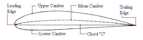

Fawzi Da
Hello everyone!
I wanted to ask if the wing thickness is the same meaning as camber?
Thanks in advance
No, they are two different parameters. Camber describes the curvature of the airfoil. Thickness is exactly what it sounds like. Thus, you can have a thick, low camber airfoil (like this one: http://avstop.com/ac/basichelicopterhandbook/2.jpg ), a thin, low-camber airfoil (http://static.rcgroups.net/forums/a...b-3dhs_extra_shp_airfoil_01c.jpg?d=1224138433), a thick, high camber airfoil (http://ec.europa.eu/research/transport/images/projects/44_1.jpg ) or a thin, high camber airfoil (http://www.wattflyer.com/forums/attachment.php?attachmentid=138520&d=1289149584).
Fawzi Da said:
Hello everyone!
Thanks in advance
The attached image shows a typical cambered airfoil:
Airfoil sections are typically defined with no camber, such that the ordinates of the section above and below the chord line are symmetrical. Such an airfoil typically requires a non-zero angle of attack (AOA) in order to generate lift. Transforming a symmetrical airfoil by applying a camber line typically produces a new airfoil shape which can generate lift at zero AOA.
https://en.wikipedia.org/wiki/Airfoil
Different airfoil shapes and camber lines are cataloged by various organizations like NASA (successor to the NACA) and others.
