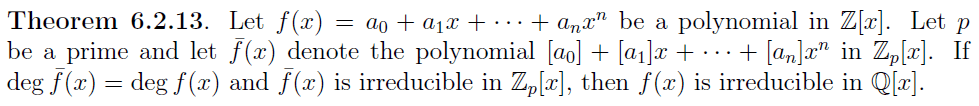

Hi all, appreciate your help to look through my answers to see if they are correct.
Thank you.
