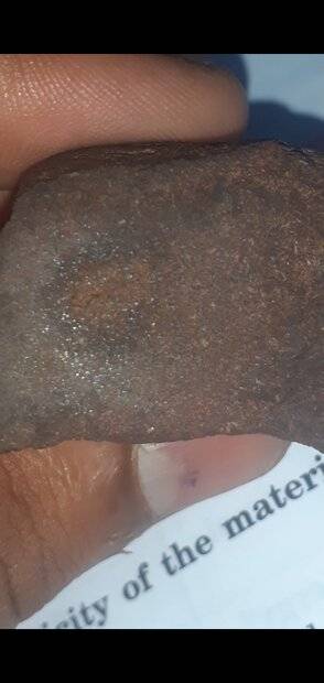

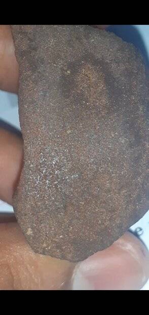

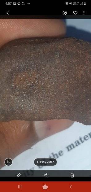

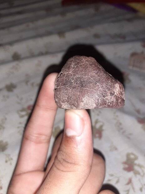

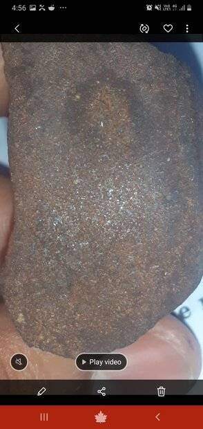

Iam in the process of getting an authority to either confirm or decline it as a proper meteorite. When I looked up for photos on internet it looked exactly like a meteorite. Now talking about stone it appears to have fusion crust, it is magnetic and possible metal flakes. Really needs some experts help.
A hand held up outdoors against green foliage, holding a rough brownish-red rock about the size of a walnut with a pitted, knobby surface.
A hand holding a small rough reddish-brown rock with a dark, pitted, slightly fused-looking outer surface, outdoors against a sandy background.
Close-up of a small reddish-brown rock held between two fingers outdoors, with a blurred green palm and sandy ground behind it.
A hand held up to show a small, rough, reddish-brown rock with pale veins and a crusty surface, against a floral-patterned bedspread.
Close-up of a dark brown, rounded rock held between fingers, with pale lighter patches and thin light veins across its rough surface.
Close-up photo of a rough, brownish-red rock held between fingers against a dark background, with a fractured surface showing lighter pale patches and fine cracks.
Close-up of a reddish-brown rock surface with a fine granular texture and scattered small glossy, reflective grains catching light.
Close-up photo of a dark brown, pitted rock surface with a glossy texture, crossed by thin pale branching lines forming a network of cracks or veins.

While we get to Australian time, let's start with the bad news:
1. A photograph cannot prove a stone is or as not a meteorite. You need to send it to a lab. Labs expect to be paid, evem if the answer is "no".
2. Most rocks thought to be meteorites are not, so the odds start out against you..
Relevant features:
  • Magnetic - moves the odds up, but lots of earth rocks are magnetic too.
  • Fusion crust - I don't see one. Do you have a section? (Is that what the 2nd to last picture is supposed to show) All I see is that the outside is dark. Lots of rocks have a dark outside.
  • Regmaglypts - Don't see any. Moves the odds down.
  • White mineral - if this is quartz, it is not a meteorite.
Patel het said:
TL;DR Summary: Iam in the process of getting an authority to either confirm or decline it as a proper meteorite. When I looked up for photos on internet it looked exactly like a meteorite. Now talking about stone it appears to have fusion crust, it is magnetic and possible metal flakes. Really needs some experts help.
looks like a very good Ordinary Chondrite to me
Has the remains of a very old and weathered fusion crust. It's been on Earth a very long time and the crust is no longer black
The shiny "white/silver" material looks like the Iron just shing cuz of the angle the photo was taken relative to the stone
The spread of that "metal" throughout the rock is indicitive of how metal is spread in a choncrite

Patel het said:
So at the end this is a meteorite right? My first meteorite and literally a dream come true! It won't matter to mean if it is very comman or rare iam just going to keep it with me as my first meteorite ☄
I have no reason to believe that it isnt. A lab test would be the final confirmation.
I have been collecting meteorites ( and rocks and minerals - for that matter) for a long time.
I have over 300 meteorites in my personal collection and over 500 rock and mineral specimens.
Every day in various Facebook groups I see and tell many people that they have meteorwrongs
instead of meteorites. 99% of rocks that are shown (asked about) in the groups are meteorwrongs.
Slag from glass or iron foundaries is most common, volcanic rocks such as basalts also a very
common wrong
I would love to see a better/sharper photo of that cut surface
Also, where did you find this rock ... Home country ? which is where ?
As @Vanadium 50 said, magnetic attraction isnt a good proof. Many Earth rocks are also
attracted to a magnet and on the other hand, not all meteorite are attracted to a magnet.
For example, achondrites that include Martian, Lunar and the Vesta asteroid H.E.D. groups
are almost to completely devoid of metal and therefore wont stick to a magnet.
Iron in chondrite meteorites is sprinkled through the rock like in your and my samples.
Iron and other metals in Earth rocks tends to be more clusteres along seams as much of
it is hydrothermally deposited ... ythink veins of gold, copper, antimony etc etc
Iron in Earth deposits tends to be in bulk mass and often heavily oxidised in the forms of
limonite, magnetite, hematite etc. Physical, metallic, iron in the Earth's crust is extremely rare
In fact, probably, 98-99% of that which is found would be in meteorites.
Metallic iron is found in 3 type of meteorites
1) stones as in chondrites - this is crustal material of asteroids
2) Stony-Irons as in Pallasites and Mesosiderites they are from the mantle and the mantle-crust
boundary of an asteroid
3) Irons as in Nickel-Iron meteorites from the cores of broken up asteroids
cheers
Dave

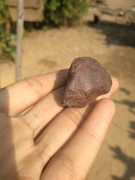

iam from india. And it was found in my backyard. Since a year I was watching videos, photos ,websites and threads related to meteorites. Since then I wanted a meteorite really bad. I could not go for meteorite hunting anywhere (since iam 15 years of age) so I decided to take a chance and test my luck. I tried to find a meteorite in my backyard as it was filled with rocks. It is still unbelievable that a space rock was resting in my backyard and didn't knew! Here are some photos of cut sections with some metallic flakes visible and sorry for poor quality of images.
Close-up photo of a rough, dark brown stony rock held in a hand, with a pitted, grainy surface and small pale specks visible across it.
Close-up photo of a dark brown, pitted stony rock held in a hand, with a rough, slightly reddish-brown fusion-crusted surface, over a printed page edge.
Close-up photo of a dark brown, rough-textured rock held between fingers, with small pale speckles and a lighter patch on its surface, over a sheet of white paper.
Close-up photo of a dark brown, pitted rock held in a hand, with a rough, slightly glossy surface and small pale flecks scattered across it.
Close-up photo of a dark brown, pitted stony rock with a rough, grainy surface and a few reddish-brown patches, held between fingers against a light background.
Close-up photo of a dark brown, roughly textured rock held between fingers, with a printed page edge reading "...ciety of the materi" in the background.
Close-up photo of a dark brown, rough-surfaced rock held between fingers, with small pale speckles and a lighter crust-like patch on its surface, shown against a white background with partial printed text.

Here are the contrasted images of the cut section
Close-up photo of a small brown stone held between fingers, with a dark, slightly pitted and grainy surface and lighter speckled areas.
Close-up photo of a rough, dark brown and rust-coloured rock held in a hand, with small pale speckles across its pitted surface; a video playback control overlays the lower part of the image.
Close-up photo of a dark brown, rough-textured rock held between fingers, with a printed page edge visible at the bottom reading "...icity of the materi...".
Close-up photo of a dark brown, rough-textured rock held between fingers, with a small pale circular patch on its surface; a printed page with partial text is visible beneath.
