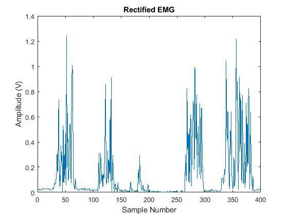

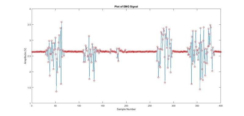

Hello
I'm working on project for "design & implementation of EMG data acquisition"
for now I completed the design and connected the output of the system to arduino uno to read the emg signal in real time with MATLAB 2017b using arduino support package.
the problem is that the signal looks as its sampled in wrong way although when i used oscilloscope the signal was very good so this means the hardware is working fine, is this problem could be related to ADC of the arduino or the communication between arduino and matlab??
the attached image shows the plot of the signal in matlab.
any suggestion...

  • Line plot of an EMG signal in MATLAB: amplitude in volts against sample number 0 to 400, baseline near 2.6 V with bursts of large swings up to about 3.6 V and down to about 1.4 V, red circle markers on each sample.
  • Line plot titled Rectified EMG: amplitude in volts (0 to 1.4) against sample number (0 to 400), showing bursts of activity between roughly 30 and 300 and a baseline near zero.

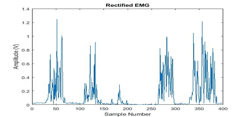

Can you show a picture or screenshot of your o'scope signal, since it is reading correctly? I don't know enough about the Arduino to know if it is loading down your EMG output. Is your oscilloscope on an unloaded signal, or while it is hooked to the Arduino?
It is a little hard to tell with the plots having different horizontal sizes, but it sure looks like the second plot is the AC coupled, fullwave rectified version of the first plot. (or perhaps not AC coupled but with the 2.6V offset removed)
Here are the two plots at the same scale and another with them combined.
MATLAB plot titled Plot of EMG Signal: amplitude in volts against sample number from 0 to 400, with bursts of spiky activity around a flat baseline near 2.6 V.
Line plot titled Rectified EMG: amplitude in volts (0 to 1.4) against sample number (0 to 400), showing bursts of rectified EMG activity peaking near 1.2 V.
MATLAB plot titled Rectified EMG of amplitude in volts against sample number from 0 to 400, showing a blue trace with bursts of high amplitude and a flat red line with circle markers near 2.6 V.

  • Line plot titled Rectified EMG showing amplitude in volts against sample number from 0 to 400, with bursts of activity peaking near 1.2 V and quiet baseline sections near zero.
  • MATLAB plot titled Plot of EMG Signal: amplitude in volts against sample number from 0 to 400, with bursts of spiky activity around a flat baseline near 2.6 V.

  • Line plot titled Rectified EMG: amplitude in volts (0 to 1.4) against sample number (0 to 400), showing bursts of rectified EMG activity peaking near 1.2 V.

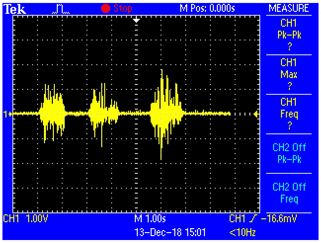

Thanks Scottdave
This screenshot shows the output of the system which connected directly to oscilloscope, knowing that the sample rate of this scope is up to 2 GS/s Real Time
  • Oscilloscope screenshot, channel 1 at 1.00 V per division and 1.00 s timebase, showing three bursts of yellow noisy signal on a flat baseline; time stamp 13-Dec-18 15:01.

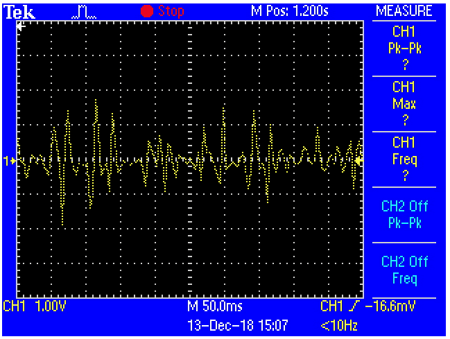

  • Oscilloscope screenshot on a Tektronix display, CH1 at 1.00V per division and 50.0ms per division, showing a noisy yellow trace of irregular spikes around a central baseline, timestamped 13-Dec-18 15:07.
Cheers,
Tom
Thanks, Tom
About the 2.5 offset, I made it in hardware "DC level shifter" because I want to shift the signal up so all signal will be in positive side, to let the ADC of the arduino digitized correctly.
I hope you understand me..

Mo_Tuk said:
Can I change the sampling frequency of the ADC to higher one, so the EMG signal will be plotted more smoothly and has more sampling points.
I think that's the real issue. What is the sampling rate, right now? I'm trying to figure out from the plots. If there are 2 seconds between pulses, then that's about 75 samples in 2 seconds ~ 40 samples per second, maybe.
Mo_Tuk said:
Can I change the sampling frequency of the ADC to higher one, so the emg signal will be plotted more smoothly and has more sampling points.
Maybe. If I'm reading the scope settings right (50ms per div), the scope trace you posted as 2.PNG shows the highest signal frequency is about 100Hz. So far you haven't told us the sample frequency you are using. Since the minimum sampling frequency needed is twice the signal frequency, you need to sample at 200Hz or higher. You can use a higher sample freq. if you wish; any higher than 4 or maybe 8 times the signal frequency is generally of little use for anything other than drawing pretty pictures (traces).
For computation of which fingers are doing what, your existing data looks fine, in fact may even be too much data! (looks fine to me anyhow, but I've never built the system you are putting together :smile:)

The designed system has (20 to 500 Hz) band-pass filter which means that the emg signal frequencies should be in this range,and as Nyquist Theorem the minimum sampling frequency in this case should be at least 1k Hz, and I searched about ADC of the arduino and found that it has deafult fs=9600 Hz.
if ADC of arduino works fine, what is the problem then? or should I have external ADC ?
