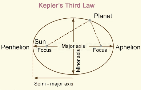

However, I am not a mathematician and don't understand how this
Diagram titled Kepler's Third Law showing an ellipse with the Sun and a second focus, the major axis, minor axis, perihelion, aphelion, a planet, and the semi-major axis.

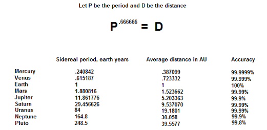

translates to this
Table comparing sidereal period in Earth years, average distance in AU, and accuracy for the eight planets and Pluto, with the formula P^0.666666 = D above.
Can somebody help clear this up for me ?
Thanks,
Joe

[tex]P^{0.666666...} = P^{\frac{2}{3}} = \sqrt[3]{P^2}[/tex]
Kepler's law says:
The square of the period of any planet is proportional to the cube of the semimajor axis of its orbit. or
[tex]P^2 \propto D^3[/tex]
Kepler's third law states: The squared orbit periods of two planets are proportional to the cubes of their semi-major axis.
That is
\frac{P_1^2}{P_2^2}=\frac{a_1^3}{a_2^3} \textrm{ or } P^2 \sim a^3 \textrm{ or } P^{\frac{2}{3}}=P^{.66666} \sim a
and your (and Kepler's) average distance ##D=a## is the length of the semi-major axis. The proportional factor is the Gaußian gravitational constant. For the derivation, see https://en.wikipedia.org/wiki/Specific_relative_angular_momentum.
