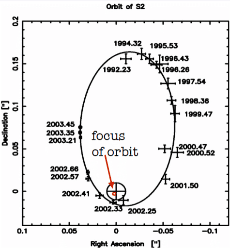

The discussion revolves around estimating the mass of a central object based on the orbital motion of star S2, utilizing Kepler's 3rd law and graphical data provided during a class lecture. Participants explore the interpretation of the graph and the necessary parameters for the calculation, including the semi-major axis and potential corrections for orbital tilt.

I want to understand how one can go about estimating the mass of a central object given the a graph the orbital motion of S2, or any given star for that matter.
During one of my class lectures, we were shown a graph of star S2's orbit motion (shown at the bottom of this post) and was told to try and figure out how to find the mass of the central object using Kepler’s 3rd law in solar units, as shown below:
We were also given a hint to use the arcsec relation and read the radius of the orbit from the image, as shown below:
From my notes, it looks like we had to use the declination value of 0.1, but I still don't understand how exactly we got to that point. Does anyone happen to know why this is and how to generally use these types of graphs to estimate the mass of a central object?

The "radius" in the formula is actually half the semi-major axis of the ellipse (which obviously doesn't have a constant radius). Based on the diagram, 0.1'' might be a good estimate for the semi-major axis.
As @pasmith said, reading from the diagram, the semimajor axis is about 0.1". This is the θ in your second formula. It is not a declination, it is the angular size of the orbit.
