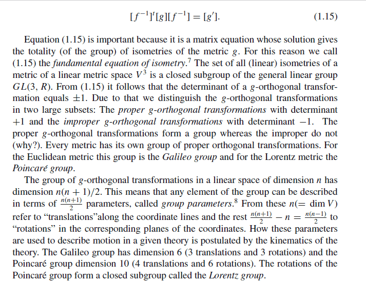

Be f a orthogonal transformation and g being in the canonical form.
$$[f^{-1}]^{t}[g][f^{-1}] = [g']$$
So this equation of isometries implies that the diagonal of g is +- 1, but, apparently, if it is minus one it can't be a group, and i don't know why.
To make the things clear, if det = +1, in the Lorentz metric the g is the Poincaré group

Hi, it is not a question, it is a doubt about the text i was reading, probably this is a justification to the confusion in the OP, i am still trying to get the theory :)
Anyway, i think you give the det of f, but i am asking for the det of g, to be clear, i will post a image of the text, sorry any misunderstanding, i am trying to get it yet ;)
Do you see the why on the text?That is actually the question, why the negative det do not form a group.
Ok, i believe i get the answer, if we define a group of det (-1), and their elements A and B, the product of their owns elements leave outside the group, that is: det(AB) = det(A)det(B) = 1, so it is not a group at all.
